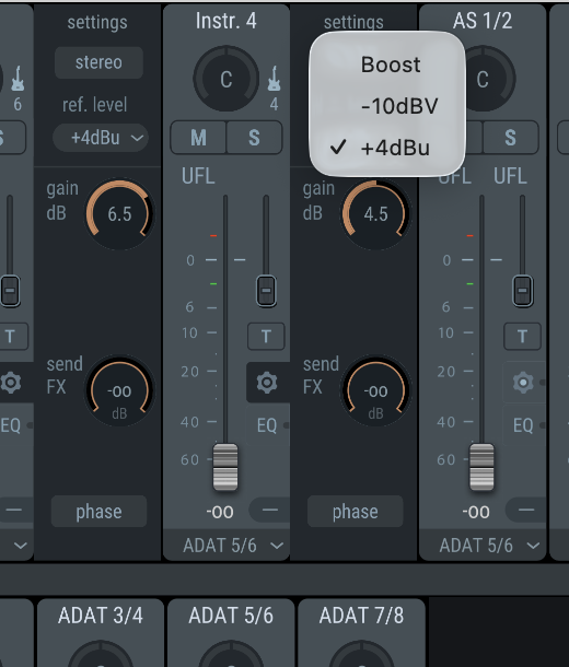

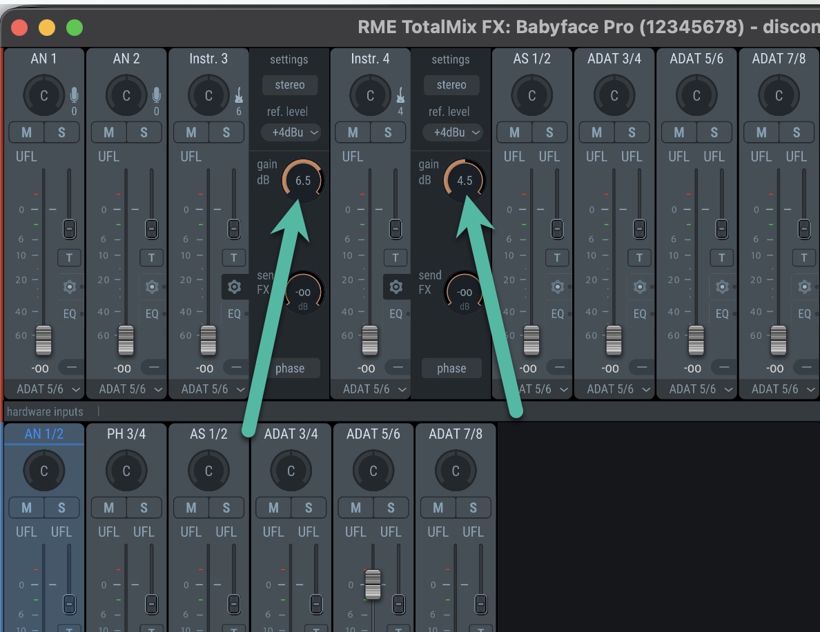

Also, isn´t it possible to trim the gain of the hi-z input, or is it me, and AI, that are missing something?

And here is the gain setting for the instrument inputs

I´d had to choose Class Compliant because I failed to install 4.3 drivers, I had work to do, I was doing over the phones, But thank AI, not anybody else, I managed to install them correctly, and back to work. Nevertheless it doesn´t explain why I miss my class compliant phones out, namely in iOS, because there I have no alternative to use any other drivers but CC. And, I have two phones out, and none working.
Furthermore I asked if there is a way of trimming the Hi-Z input, which obviously, no one can do it without resourcing to some DI, because there is no way to do it in TM, as it only adds more gain.
So, unless one turns down the guitar volume down, and mess with the guitar tone doing so, the monitoring is done without clipping in your dreams.
    IMO, that´s a major flaw in the circuitry. no one wants clipping, or use line inputs, instead of Hi-Z because that alter the tone too, even transients of the guitar signal.
so what´s your role here, besides stringing people along?
You gave no solution, neither explain the philosophy behind this unorthodox behavior of handling the audio path.

My previous post was not helpful for you, sorry for that I didn't understand your gain setting issue.
In the past there was a lot customers complaining weak guitar signal, not enough gain.
RME did firmware and Totalmix update and added Boost as a new reference level setting.
There are three settings you should try all of them for testing
https://i.ibb.co/Ngk5QFFX/boost.png

    Once, I referenced those selections. I choose -10 because it´s supposed to be a Hi-Z input, should be like a real amp, completely oblivious of my pickup output, and then, on TM, I´m supposed to boost it so I don´t starve the converters, and subtract on my recording gear the exact same amount, so the structure of the signal keeps its integrity, and the Ampsims could do their job of simulating an amp.
     Again, I think there is a methodology behind that goes way over my head. Because i don´t need boosting, and if I have to use the +4db line attenuation, i only can do it "properly" with a DI feeding the interface.
    Notice, I´m not saying the interface is wrong. I´m saying I don´t understand its gain structure, and it´s not appropriate for modern active, or high output passive guitars, as it is. And, if I noticed before buying I wouldn´t keep it for myself.
    I guess others tolerate that behavior or found out a way to work with it. the only solution I got was to back off a little the guitar volume knob, but sometimes i want to have it fully on, and i can´t do it without compromises.

I’m using a cheap passive DI on input 1, I tried both with the pad on and off, no clipping on either setting, so I kept going with the pad off, and I rose the gain 35db without clipping.
     Then I got back to try the BFP Hi-z, and no headroom, but it didn’t clip, it might be because I was playing fingerstyle, or using less strength plucking. I don’t think the DI could have any interference on this scenario.
      This morning I went back at it, the pad seems to muffle the sound, I´m not quite sure if it just lowers it, but it feels like a slight roll off on the guitar volume, taking out the poisonous frequencies that might set back rhythm playing to a uncontrollable mess, but sometimes I like it fully open.Frankly, most of the times, as I might dial down the gain on the software I´m using. The hi-z input returned to its behavior, it shows clipping every time i hit the strings harder, and on the lower strings most of the time, both on +4dbu, or -10dbv. They sound both quite well, but clipping shows its ugly face. nevertheless, rarely the green goes past 22db, but then the red starts to warn me about clipping.
I wonder, am I right, are the meters right? but that shouldn´t be an issue, when I purchased the BFP, I thought I was buying into no problem, straightforward flexible setup. Until now, that´s not the case.
I heard the Hi-z input lack of headroom was by request of the forum members, and done with a firmware update. It doesn´t seem they thought it well enough.

Did you try the input reference level +4dBu ?
It is still Hi-z input but the input gain stage is different.
1,586
Re: The official Babyface Pro Thread
Yes, my previous interface supported +20db input, versus the +13db of the BFP. The input clips at the +4db setting, not as much but it clips, I was considering using that option. But this an obvious downgrade of my signal path. I already contacted the seller. I have no more issues with the BFP.
BTW, every interface on this price bracket, or format, like the UltraLite, Symponhy Duet 3, Apollos have such limitation, it seems they are not targeting guitar players, with modern high gain pickups. The exceptions are very scarce.
