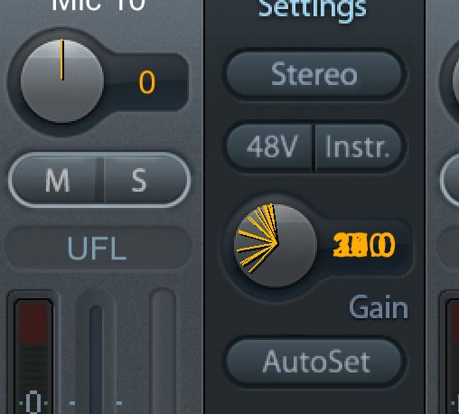

Today I had the opportunity to really work with the new TM Remote for the first time at a live show that will happen tomorrow. Today we just had set-up and soundcheck with a 6-piece rock band into the UFX+ using its mic pres and line inputs and a Digimax DP88 over ADAT. Soundcheck was done completely on an ipad.
Overall it's really great working this way using TM Remote but nevertheless I was stumbling upon a few things I'd like to share.

3. The Fireface's MIC gain knobs on the ipad do not seem to refresh when adjusting them. The channel's settings need to be closed and opened again to see the current value.
http://www.ttx-sound.net/foren/IMG_0147.jpg
This was fixed in the just released remotes 1.01 and the new iOS v1.13. Thanks for the info.
