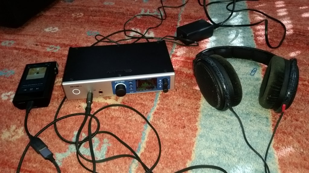

began to think, that Astell & Kern may have the necessary >USB On The Go< feature (I wrote >... to go< above, my mistake). I searched for an USB On The Go cable with USB C plug and found in my box on:
https://www.amazon.de/Anker-Weiblich-Ve … amp;sr=1-3
I made a try:
http://www.rawac.de/bilder/KannAlpha_with_ADI2Pro.jpg
It works with this cable, without doing anything else then putting the hole cable thing together as shown in the picture. PCM is selected in the Kann. USB mode was selected by the ADI-2 Pro automatically. Seams to be a question of the right cable.
I looked in the manual of the SE200, page 37, he has the same feature.
Ralf
