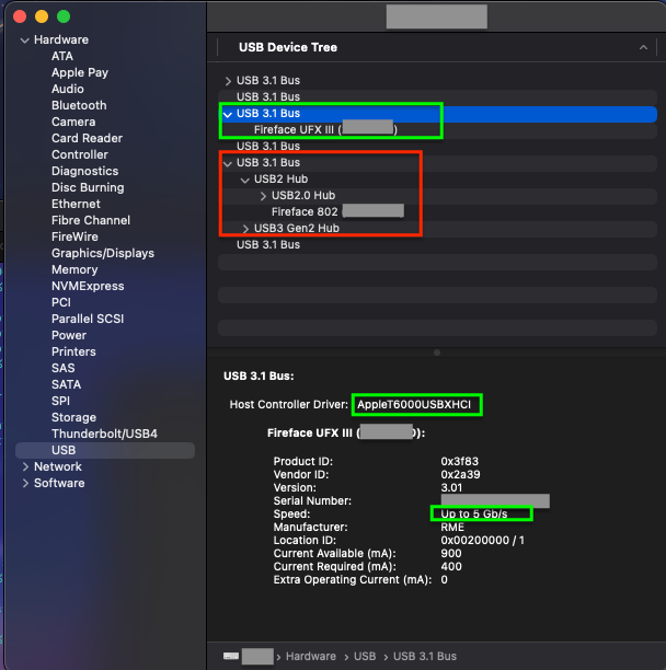

Few days ago, I came across this article
https://eclecticlight.co/2022/04/18/m1- … 3-1-gen-2/
Which lead me to an idea - Maybe, the users, here having problems with UFX III (and probably other USB3 units) could verify this:
Check your in your System Information App on Mac:
- Your unit is connected and recognized as the one (and only!) inside a USBXHCI Controller
- Speed is marked as "5 GB/s"
See my example screenshot.
- Green Box:
   -> OK (at least in my case, as the UFX III is the one and only unit connected to the USBXHCI Controller).
- Red Box:
   -> OK for my FF802 (as it uses USB2) and the controller shares some other devices and hubs...
   -> If the UFX III would appear there it would be (probably) not be OK
Please, try to post as detailed as possible (best with screenshots).
Answers like: "Doesn't work" or "Tried. Still glitches" do not help at all.
https://i.ibb.co/ymxrXM4M/usb3-busses.png
PS: This is just an idea - definitely no warranty or a solution at all...
Edit 26.03.15: Updated expired image link
“Do It For Her”

It is advisable to connect audio interface directly to computer, not to USB hub.
Though this should be the first thing to try, this sort of advice is far less clear cut than before. Even if it applies in this particular case, thinking about the USB-C cables we use to connect USB2, USB3, and TB equipment, and any respective docks, it's impossible to say if connecting the device to a dock or hub with a more stable chipset than Apple's own mutable protocol bus, wouldn't actually help. We simply don't know what's in the kernel, and it clearly is a confusing mess at this moment.
My FF UCX is permanently connected to a Sonnettech TB4 hub (Dual M.2), more specifically one of the SS USB-C ports at its front, using a USB-C to USB-B cable, and the performance is the same as every other USB port on the Mac that I've tried (DK meh, Kext great), and using the kext drivers I am enjoying a stable system at the cost of "adjusting" SIP.
If I read the posts around here correctly, RME seem to have adopted a "wait and see" approach, and I think it's obvious that Apple won't fix this any faster than they have so far.
It might be useful to share some tools and methods to help diagnosing what's happening under the hood. For example, using System Information > USB, I can see that my RME FF is connected to a GenesysLogic USB controller managed by "AppleUSBXHCITR" and there's nothing around it. At the same time my MixPre-D, connected directly to the back of the Mac, shares an Apple USB bus with the keyboard plugged in next to it and with my VIA/Orico USB3 hub connected to the front port of the Mac, driver "AppleEmbeddedUSBXHCIASMedia3142".
hope this helps.

It is not just connecting directly to computer. The propper USB socket should be used. And maybe certain USB sockets not being used by other HW (it depends on computer model...)
One has to have a look in device manager.
