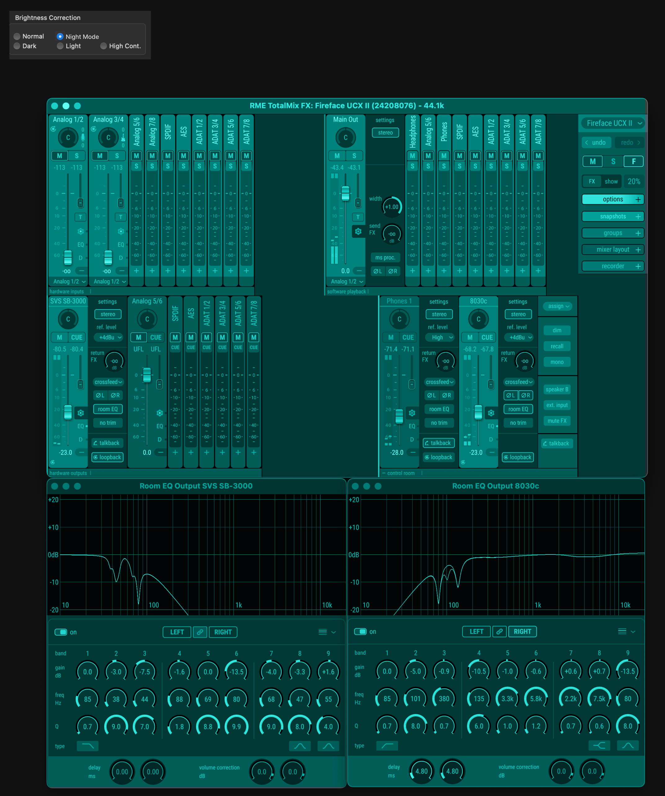

i am an expert in user interface design and love rme products very much.
so there is the aspect of scotopic view, night vision, which may come in handy for some people (it illustrates why in some movies control room screens sometimes have this appearance):
at a wavelengths of around 507nm, the perception of color frequencies in the eye is best at night, to put it in simple words.
so here is something you could consider:
http://evancales.net/nightmode.png
this will probably not show up in here since you ruled out http content. but you can still have a look wink feel free to get in contact in case you like this idea.
rme fireface ucx II, velodyne spl-x 10, supra eff-isl, genelec 8030c
