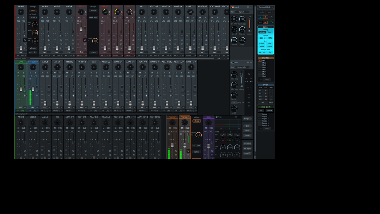

I have 3 related issues to report on TotalMix 2.0 beta 13:
1. I'm not sure if this has been reported already, but it looks like the minimum window size is way, way too small as of TotalMix 2.0beta13, meaning it's possible to set window sizes that leave TotalMix in some odd UI layout states:
https://i.imgur.com/jMRQsGE.png
2. If you switch from the new design to the old design, then back to the new design via `Toggle Old-New Design`, the minimum window size changes to be even smaller than before. This is what it looks like:
https://i.imgur.com/hiqYsyN.png
3. While resizing TotalMix between some of these ridiculously small window sizes, TotalMix crashed. Here's an excerpt from the macOS system dump (totally happy to send the whole thing via email if that would be helpful):
Crashed Thread:        0  Dispatch queue: com.apple.main-thread
Exception Type:        EXC_CRASH (SIGABRT)
Exception Codes:       0x0000000000000000, 0x0000000000000000
Termination Reason:    Namespace SIGNAL, Code 6 Abort trap: 6
Terminating Process:   TotalmixFX [1461]
Steps to reproduce the crash:
1. Quit and relaunch TotalMix beta
2. Make sure TotalMix launches with the new design active
3. Toggle Old-New Design to switch to the old design
4. Toggle Old-New Design to switch back to the new design
5. Drag from the bottom right corner to resize the window as small as possible (see screenshot above)
6. From this tiny window state, try dragging the rightmost drag handle to enlarge the window horizontally. You might have to drag this back and forth multiple times.
Expected: The window resizes normally.
Actual: TotalMix crashes.
Let me know if there's any more information I could provide that would be helpful here!

Ich habe noch ein spezielleres Problem entdeckt:
Bei mir kommt es öfters vor, dass ich Musik am laufen habe aber mein Fireface 802 noch nicht angeschaltet ist. Wenn ich im laufenden (Musik)betrieb das Fireface starte wechselt mein Mac automatisch auf die Audioausgabe des Firefaces.
Ich habe  allerdings Totalmix immer offen im Fullscreenmode auf einer meiner Spaces (Mission Control). Wenn ich nun das Fireface 802 anschalte, passiert eine art Grafikfehler in der Totalmixoberfläche.
Es sieht dann folgendermaßen aus:
https://i.postimg.cc/gjx56qNg/Bildschirmfoto-2026-02-18-um-08-45-12.png
Herzliche Grüße und viel Erfolg bei der weiteren Entwicklung

Das mit dem wechsel der Musikausgabe auf das frisch eingeschaltete Audiointerface ist bei mir auch so, ich denke das ist normal.
Ich finde es auch gut dass ich da nicht extra noch in die Systemeinstellung muss um das Audiogerät auszuwählen.
Das mit dem Fullscreenproblem konnte ich nicht reproduzieren.
Habe das gestestet mit meinem Digiface USB, Totalmix offen, Digiface USB offline device, fullscreen,
dann das Digiface eingesteckt und alles bleibt normal, Totalmix voll gross über den ganzen Bildschirm, alles bestens.
Einen zweiten Test gemacht mit offline device FF802, selbes Resultat.
Was ist dein computer genau ? Ist das ein zusätzlicher Monitor-Bildschirm ?

Mein System hätte ich natürlich einmal mit angeben können. Das es automatisch umschaltet ist auch wirklich top!
Mein setup ist:
MacBook Pro M5. Mac OS 26.3.
Externer Bildschirm. Angeschlossen über ein Caldigit TS 4 (bestes Thunderbolt 4 Hub auf dem Markt).
Das Graikproblem tritt immer mal wieder auf (externer Bildschirm). Wenn ich es direkt nach dem ersten Mal ein zweites mal reproduzieren will erscheint es nicht.
Herzliche Grüße

Und ohne externen Bildschirm, nur auf dem Macbook ?
