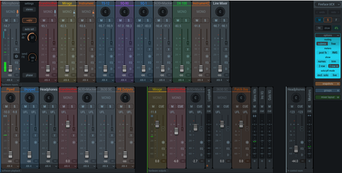

Re: TotalMix FX 2.0 – first beta available for Windows (now released)
The Look
https://www.archiv.rme-audio.de/images/tmfx2_ucx2_winmixb2.png

Many thanks for the Windows version.
Here's an example of how it looks on a Full-HD screen with Brightness Correction “High Contrast” turned on, which improves readability.
https://www.dropbox.com/scl/fi/oc7cg0em … 2&dl=1
https://www.dropbox.com/scl/fi/oc7cg0emli2vc6d9lh816/2025-10-06-TotalMix-FX-2.0-Beta-1-Brightness-Correction-High-Contrast.jpg?rlkey=6ej1b0ukjpc9kzyo2x5medkjh&st=u311py22&dl=1
More recent version of TM FX 2.0 Beta 2 with
- better y-resolution on 94 ppi Full-HD screen (16:10, 1920x1200)
- fewer channels by combining Loopback and DURec channels
- more channels hidden and collapsed
https://www.dropbox.com/scl/fi/4nn2dcv3 … 9&dl=1
https://www.dropbox.com/scl/fi/4nn2dcv32atudgzx67rx1/2025-10-13-TM-FX-2.0-Beta-2-v051-Channel-Layout-2.0-Narrow.jpg?rlkey=pokjufflzi8bi6jm3futvtlo4&st=fg03jab9&dl=1

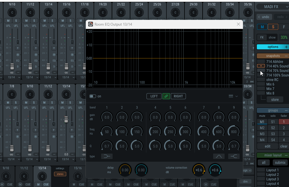

Looks and feels great.
I still find it a pity that the volume correction of the Room EQ is not included in the snapshot. It very much should be imho.
Georg
https://gifyu.com/image/bw8Xf
https://s14.gifyu.com/images/bw8Xf.gif

i'm on mac but i think that it does not matter at this point : i was, also, wondering why volume correction would not be reflected in the yellow dot indicator when eq was not ON (when not equals to L zero/R zero, of course) + stored in snapshots
Georg

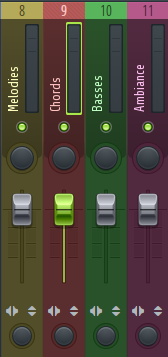

yeah agreed...contrast needs work...better able to distinguish numbers on old TotalMix.
This needs to be reviewed please...
Also ive noticed some pics in this thread show channels of different colors...how do you do that..cant find an option for that..apart from that it is generally an improvement..Thanks
