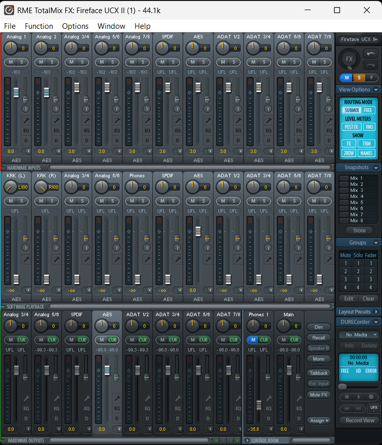

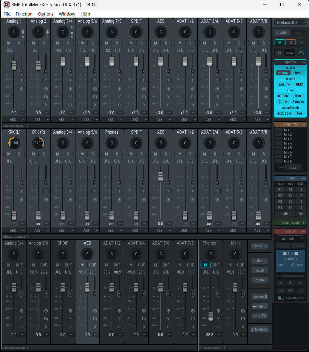

Trommeltotti wrote:
A suggestion for marking the respective hardware output channels: How about a colored border around the selected hardware output channel?
+1
I suggest the same orange color, that is used for indication of activity (loopback, etc...) within TM.
Trommeltotti wrote:
At the same time, the associated hardware input channels and the software/playback channels should also be framed in the same color.
In addition to the fader position, this also makes it easier to see which channels are actually assigned to the respective hardware output.
This might be good, if there are many channels. While one may also use submix button, this would be still cool.
May be configurable for those who do not need it.

Re: TotalMix FX 2.0 – first beta available for Windows (now released)
+1
I'm thinking more of the respective color, which has been individually assigned to the corresponding hardware output.
In the new TotalMix beta version, there is now a mouse over function, where the respective channel names of the hardware outputs will light up brighter when you move the mouse cursor over them. If the corresponding frames of the assigned hardware inputs and the software/playback channels are displayed at the same time, you have a visual overview of the corresponding routings in front of you in a flash. This is a temporary 'sub' display form without hiding the other channels.
As @ramses has already suggested, this visual behavior should be able to be switched on and off in the preferences.
Fireface UFX II - Babyface - HDSPe AIO - Multiface

69 (edited by Kubrak 2025-10-16 08:55:05)
Great, Matthias! Thanks.
The implementation of submix fader framing is even better than I have suggested (orange frame). This is visualy clean and I guess most users will prefer framing to not framing.

One more thing concerning indication of selected submix output.
If one presses Show/ Trim button (in Control Stripe) all outputs become light color. The same that should indicate selected submix output. If one has framing set on the frame is drawn, so for those who use framing no real problem, just for those with framing set off.
76
There is no Submix selection in Trim mode. Think about it...same in old version. Means the frame should be removed in that mode.
OK, did not know. I do not use Trim mode. I just hit the button out of curiosity and saw the inconsistency in visual feedback.

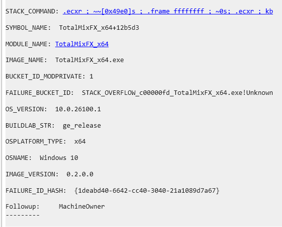

Just a note that importing a room eq preset (stereo) immediately crashes Totalmix. Beta 2 crashed when I tried to open a .tmreq file. Beta 3 crashes even before the file open window opens. (On Win11)

Been testing the recent versions and really loving it. Good catch on the REQ import crash, was about to mention it yesterday.
There's one issue I stumbled upon today on Beta 9 - not really sure on the exact cause but I managed to crash my GPU driver three times already just by opening TMFX, my screen flashes black and then this is what i see instead of TMFX:
https://i.ibb.co/YTY7ZQ5f/Screenshot-2025-10-22-130935.png
My GPU is a Radeon RX9070XT, no oc or anything. Not sure if that's of any help, but browsing the minidump file generated by the system points to a stackoverflow error:
https://i.ibb.co/bgS7BGQ0/image.png

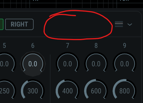

Another thing I'd like to suggest for future versions is EQ/REQ last preset used labeling, would be nice to see the name of the preset that was last loaded and an asterisk indicator showing whether it's been altered since loading, eg "abc preset", "abc preset*"
This would be a decent place to have this indicator at, since it's unused space otherwise anyway:
https://i.ibb.co/zTZLmdmj/image.png
As for regular EQ, maybe around here would work, either beside the toggle or partly over the preview graph.
https://i.ibb.co/NgdWY4v3/image.png
Anyway, thanks for the great updates!

here, first is in taskbar, second is tray. Also Totalmix is huuge on 100% compared to old 1.99 don't know if that's normal.
I am on Win 11 25H2, resolution 2560x1440 @ 125% scale.
https://i.ibb.co/99TvJ67H/Screenshot-2025-10-22-174619.png
https://i.ibb.co/Fbz8pgXQ/Screenshot-2025-10-22-174631.png
https://i.ibb.co/b5vPgK3m/new.png
https://i.ibb.co/PZ7bG28P/old.png
It's most probably the 125% scaling causing this. We'll check if we overlooked something.
Indeed the base (100%) graphics in TM FX 2 are larger than in the old version.
