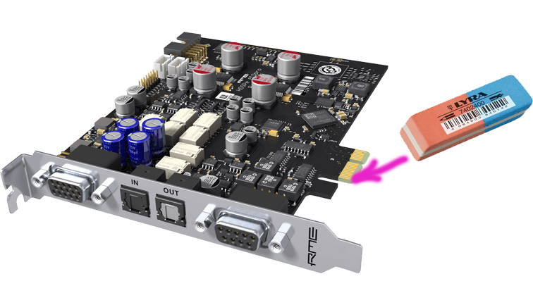

You can clean the contacts with a pencil rubber to ensure the contacts are good.

12 (edited by waedi 2025-11-17 07:32:51)
Re: HDSPe AIO pro - Totally no audio in Windows 11
;-) the motherboard is new, installed just 15 days ago, so I'm sure there's nothing dirty or with dust :-D
I mean the AIO card not the motherboard.
https://i.ibb.co/Swr5pKvW/rubber.jpg

I already did it. I tried all possible initiatives to understand what cause might be.
Come on waedi, its a new card and even new mainboard; that doesn't make any sense.
