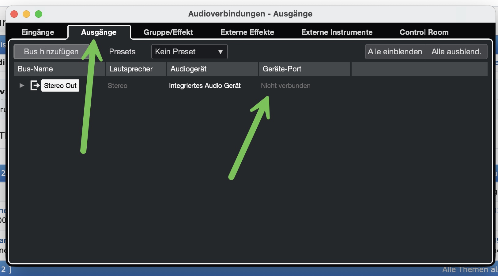

Nuendo has no connection to the ASIO driver or to the right ports.
Please provide two screenshots
Nuendo menu Studio / Audio connections / tap Inputs
Nuendo menu Studio / Audio connections / tap Outputs
By any chance the Inputs and Outputs device-ports are not yet assigned correctly I guess.
While you can select the audio device and the I/O channels are available in the project there is no audio in or out until you assign the device ports. Nuendo and Cubase are not all-automatic, it is complex and needs a lot of settings for the configuration.
https://i.ibb.co/4wxJvn2K/ports.jpg

Did you check the Audio connection device ports in Nuendo ?

And in my Nuendo 14 it is a must to assign the device-ports.
Otherwise it is exactly the same situation as you have. The driver is selected and the input and output channels are selected but no audio goes thru.
Nuendo and Cubase did a lot of changes in the architecture there. I did use Cubase 23 years ago a lot and had to learn new how to connect.

Device ports are assigned. I think that's not the problem.
Didn't you see it in his screenshot?!
See your own posting #20 in this thread: https://forum.rme-audio.de/viewtopic.ph … 31#p247131
https://www.dropbox.com/scl/fi/vy63rp2q … d&dl=1
https://www.dropbox.com/scl/fi/vy63rp2qxkqtv7kuips65/2026-01-10-Nuendo-Output-Ports.jpg?rlkey=6bnu2jpakqut9kmr22ybkpq43&st=fbq7g9ld&dl=1
