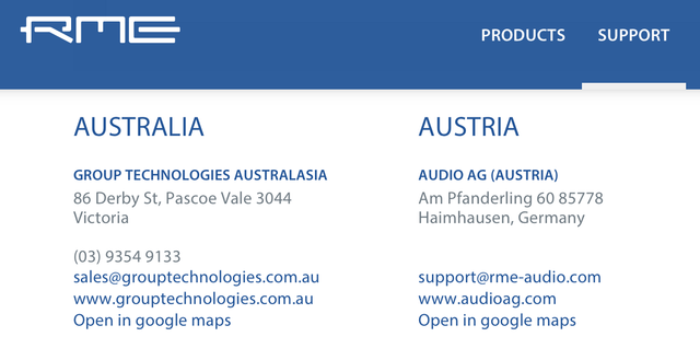

In what country are you ?
May be there is a RME service partner near you ?
By any chance you know someone to test the interface with another computer ?
Re: No sound in outputs
Austria. Nearest one is near Munich, right?
13 (edited by waedi 2026-01-24 22:15:05)
Yes correct, feel free to make telefon call
kann man auch mit dem Fahrrad hin, Katzensprung
I would try to make a test on another computer
https://i.ibb.co/s99ZqwTQ/sup.png
