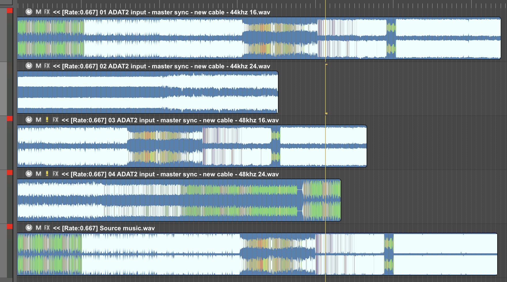

I want download all your tracks for loading into Reaper and compare.
I downloaded all tracks.
What a mess.
4 of 5 tracks have the same file name.
I had to delete them and redownload one after one and give a number to the name to have this under control.
Then imported into Reaper.
What a mess.
The source-file and recording 01 look the same, ok, but the rest is complete different.
this is not valid for a comparison.
https://i.ibb.co/BHT6vNtb/adat.png
See 01 and source are looking identical, this tells me the soundcard works perfectly fine.
The other recordings are different because you did different Dj mix on the DJ-mixer.
Recording thru digital input can not make the recording brighter or more bass-boom or whatsoever.
signal is coming or not coming.
Signal is what you deliver to the interface, it records exactly that, nothing else.
Do you use 2 toslink cables to the DJ-mixer ?
If you have only one cable from DJ-mixer to the interface, then the clock-source setting shall be clock-mode external optical (slave), that is also how I would connect :
1 toslink cable from DJ-mixer output to Babyface input.
In the Fireface USB settings clock-mode external optical input (slave)
I would let out the Alesis.
If the DJ-mixer has analog outputs only then connect these to the Babyface inputs 3/4 or 1/2
In this case : In the Fireface USB settings clock-mode internal  (master)
Record the Dj-mixer output in any DAW

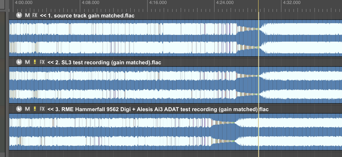

Hi, firstly thank you for your reply. I appreciate any help with this matter. I'm sorry for the mess of files - the file names have different names - they are 44/16, 44/24, 48/16 and 48/24 recordings as shown in the file names. But yes, I normalised each file and recorded at different parts of the track, and was also blending the track, so it was a poor way to try to show my issue. I apologise for that. I was originally trying different recordings frequencies + bitrates to see if that had an impact on the artificially bright recordings, it didn't. I've redone my test in a way that should be very clear to be able to hear (if not see with analysis tools) that there is added brightness somehow creeping in the chain.
It is not an issue with my mixer I am sure - I don't get this added brightness when I use the mix 1 balanced output for my monitors. I am using mix 2 balanced output to record to the RME, they are basically the same output circuitry apart from the connector type (mix 1 is XLR, mix 2 is TRS). And I am using the RCA record output to run to the SL3 sound card.
Please check my new uploads, they are gain matched: 1. source track 2. SL3 recording 3. Alesis Ai-3 + RME Hammerfall 9652 Digi recording.
https://drive.google.com/drive/folders/ … drive_link
I have no toslink cables from the mixer, it's an Allen & Heath Xone 92 which is an analog mixer.
I don't have a Babyface, I'm using an RME Hammerfall 9652 Digi and Alesis Ai-3 ADAT as specified in the topic title.
Here is my lineage for the test recording:
* Dell laptop playing WEB FLAC file in Serato DJ Pro v2.57
* Oyaide D+ USB A to B cable from laptop to Rane SL3 sound card
* RCA cable from Rane SL3 to Allen & Heath Xone 92 line input channel, no EQ or gain applied
Output 1: RCA recording output of mixer into Rane SL3 channel 3, recorded on same laptop as playback
Output 2: Short (1m) Balanced/TRS cables to Alesis Ai-3 ADAT +4dB input
Toslink cable output with new toslink cable, to RME Hammerfall 9652 Digi ADAT2 input
RME settings: Buffer 256 (6ms), Clock mode Master, Pref Sync Ref ADAT2 In. SyncCheck ADAT2 In = Sync. Sync Ref Inp. Master Freq. 48kHz.
Recorded with Wavelab 6.11 - 48kHz 24bit.
Gain matched files by peak - obviously source file is a little bit louder, but still you can clearly hear the difference between the SL3 and RME recordings - the RME is artificially adding brightness. Not sure how this is happening.
Re: RME Hammerfall 9652 Digi and Alesis Ai-3 ADAT strangeness
Track 3 is shorter, it was played faster this could sound high pitched and you think its added highs ?
Frequency spectrum looks all the same, no added brightness visible to me.
https://i.ibb.co/21m4XZR4/shorter.png
You're right about the brightness. It's strange, I was playing the tracks back through my Asus X570 TUF GAMING PLUS mobo onboard sound, and the treble was really apparent. But now playing through my Focusrite Scarlet 2i2 3rd Gen, it is true that there is no added brightness audible. This is really confounding me.
Still there is the issue with timing.. I was having huge timing/sync issues when using autosync setting - this 180bpm track was being recorded at anywhere from 0.2bpm to 20bpm difference in speed, always being pitched up.
For this newest test, I recorded into the RME's ADAT2 input - I had forgotten that during my last test, ADAT3 had ended up having the lowest timing issues (but I had thought they were all similar, I thought that my bpm analyser saying 179.98 was margin of error but maybe not now in retrospect). This current RME recording on ADAT2 is also showing up as 179.98 bpm, compared to 180.00 for the SL3 recording. I can try the test again with ADAT3 incase ADAT1 + 2 are just dying. But do you think this could be an issue with the whole sound card, or somehow the Alesis Ai-3 ADAT? The sound quality of the RME is noticeably better but I can't handle these timing issues.
I have another set of toslink cables I can test with also but I don't think it's the new toslink cables causing this issue.
It's also very bizarre that my motherboard onboard sound card was adding treble to these recordings - it makes no sense. I've never experienced this issue with my motherboard audio before. But you are right, there's no added treble when I listen through my Focusrite. This is driving me a little insane. The spek spectrums for the original recordings where I noticed the timing issues did also have frequencies pushed up in the RME recording (both recordings done at 48kHz). That was with autosync set on the RME settings though - and autosync was displaying 44.1kHz on the driver settings - compared to 48kHz when I've tested with the master sync since. So maybe it was only inputting 44.1kHz audio, yet recording at 48kHz - could this somehow 'push up' the frequencies in the recording? I wouldn't have thought so.
So it seems like somehow there is at least timing and pitch issues. No idea how my mobo onboard sound card was 'flavouring' these files though. I'll have to test that onboard sound again just so I know I'm not going crazy. I am listening to these two files from my recording last week, side by side, through the Focusrite, and as you say there's no 'super harsh treble' like it was when listening through my motherboard onboard audio. So it looks like the 'harsh treble' is some oddity I've never encountered before on my onboard motherboard audio (why only these recordings, and no other files??) - but the timing issues are definitely something wrong with either my RME sound card, and/or Alesis Ai-3 ADAT.
