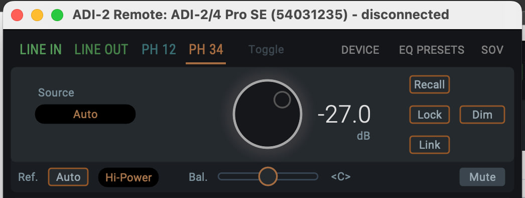

I’m not sure why discussions about the ADI-2/4 Pro so often end up with responses from people who don’t actually use the unit, while assuming that the owner misunderstands it.
Please read my original post carefully. I’m not asking to turn the ADI-2/4 Pro into a TotalMix-based interface. I’m asking for very basic control features. Is having independent volume control really such an unreasonable request?
I use the ADI-2/4 Pro for real studio tasks, and as an experienced user I’m giving feedback to the manufacturer on how the product could be improved.
The real limitation appears when the device is used “just as a converter” together with another audio interface. In that scenario, the ADI-2/4 Pro can only work in one direction at a time unless it is connected in USB mode.
If you want to use the ADI-2/4 Pro as a mastering insert together with another interface, this workflow is simply not supported. To make it work, you have to switch the ADI-2/4 Pro to be the main device, and only in Multiple-USB mode can this be achieved. At that point, it is no longer “just a converter” - it becomes the primary interface.
What I’m proposing is that adding a few simple device-level features would make this kind of work possible in a much more autonomous and elegant way. For example, why not add additional tabs on the ADI-2 Remote for digital outputs (5/6,7/8), with basic volume control and routing? Is that really an excessive request for a flagship, mastering-grade device?
https://i.postimg.cc/VN1BxmGt/photo-2026-02-11-08-21-44.jpg

I can't comment on your first point as I have no such scenario and would need to investigate time to understand the use case and audio flow.
But could you kindly detail what mode you refer to and make a short drawing of the signal flow that you need in this mode but which is not possible?
But in terms of routing / more tabs and to determine per ouput, what audio source you want to listen to, that would be cool indeed. It doesn't need TotalMix, that sounds very useful. I don't know why the predefined routings were chosen and not a per output based settings including routing, from what input audio is taken from. I can only assume there were good reasons for that.

Re: RME ADI-2/4 Pro SE - Firmware Improvements for Studio Use
I think there is still a misunderstanding here. I’m not asking for anything close to TotalMix, nor for a fully flexible DSP mixer.
The ADI-2 Remote already provides this kind of functionality - just in a limited form. What I’m asking for is an extension of the existing control concept, not a new routing engine.
For example, why is it not possible to control all outputs from the top panel, including the digital ones?
The digital outputs are already internally mapped as outputs 5/6 and 7/8, and they are accessible in Multiple-USB mode. That clearly shows that the device is already capable of addressing these outputs individually.
So the question is: why can’t these outputs be made available in other modes as well?
For the digital outputs, I’m not requesting the full feature set (EQ, loudness, dynamics, etc.). All that would be needed is:
-source selection,
-volume control,
-and basic level indication on the device display.
That does not require TotalMix-style DSP mixing. It’s simple output control - something the ADI-2/4 Pro already does for analog outputs 1/2 and 3/4.
Using an additional interface like a UCX II certainly adds flexibility, but it doesn’t address the core issue: the ADI-2/4 Pro is already very close to being a self-contained studio device, and a few small firmware-level extensions could remove unnecessary workflow limitations without changing the product’s fundamental design.
That’s all I’m trying to point out.
I think I explained the "routing" part pretty well.
For the complete use case / signal flow I didn't have time.
But the routing is like this:
For each output (not only 1/2,3/4) a Tab, where it is possible to select one or more sources for this particular output.
This is not TotalMix but fits into the current concept of having a TAB per output and an individual routing per output channel.
Comparable to submix mode, you select a TAB/an output and there you select from which sources the output shall get audio.

In the submenu "Settings," replace, e.g., "AD/DA Source" by simply "Source" and make the source port selectable.
By this, every analog and digital output can get its individual input mapped in this new operation mode, "manual".
I think from an operational perspective, at the device and using ADI-2 Remote, it would be feasible.
The question is whether this can be added to the firmware.

Regarding the implementation and operation at the device, a proposal.
A new device mode "manual" which stands for manual routing/source selection instead of Auto, AD/DA, ...
   Options -> Device Mode/DSD -> Basic Mode -> Manual
In "I/O" you can already choose between the analog outputs; there you need to add the missing digital outputs.
