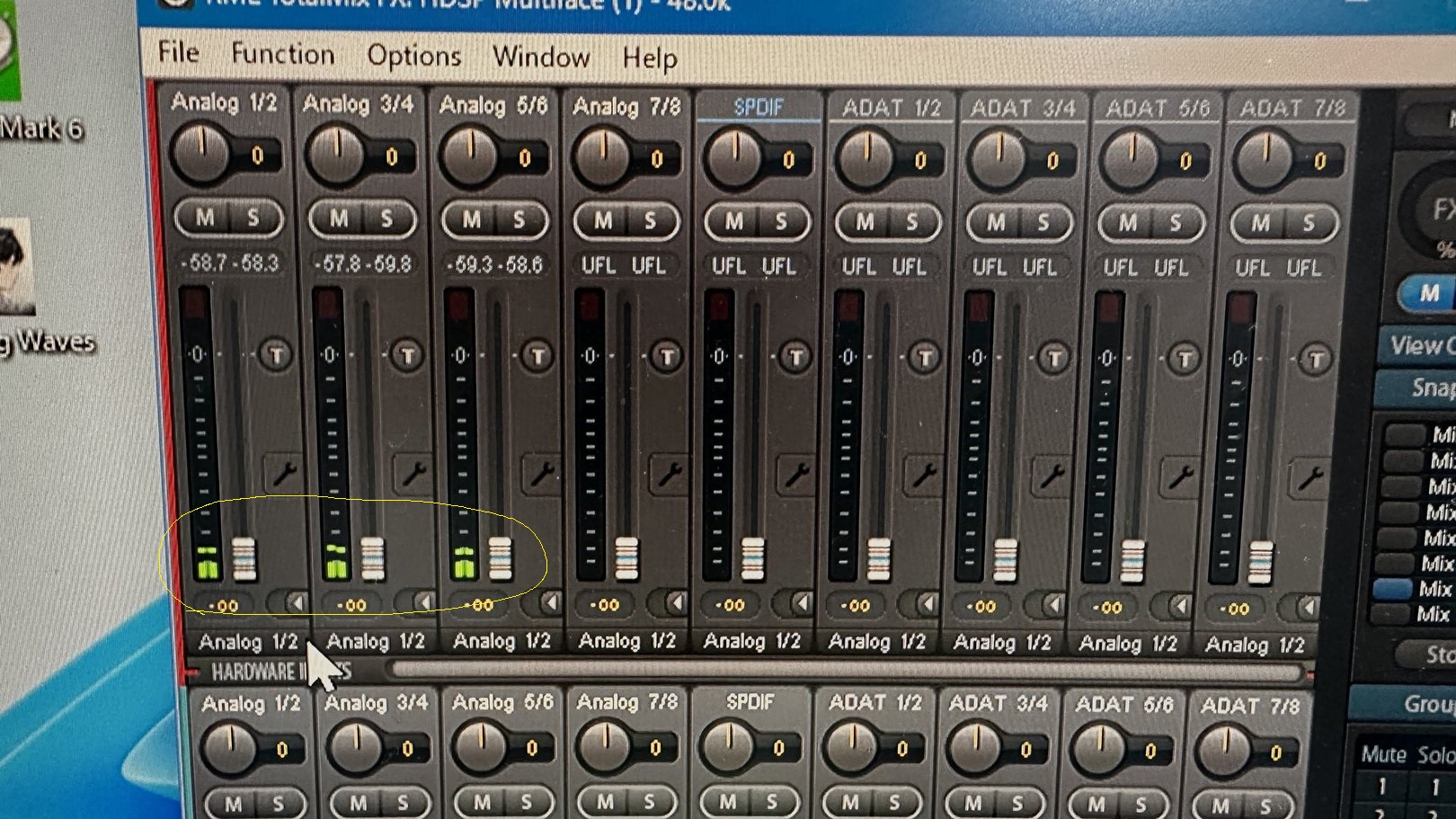

Nice to meet you. Hello. I'd like to ask about my Multiface AE. I have an HDSPe card installed in my PC. This wasn't there before, but recently I've started to hear a tiny bit of subtly audible white noise on analog INPUT 1-8.
I can hear it through headphones and monitors, and there's a green indicator from below the analog input fader in Total MIX up to about two increments, so I know there's some kind of white noise.
This may be obvious, but if I check DISCONNECT in the I/O BOX in Hammerfall DSP Settings, the green indicator disappears up to about two increments.

I noticed ch7-8 says UFL, no signal, that is strange!
Apart from the noise, do they still work? Is it plain white noise?
Re: White noise on the analog input of Hammerfall DSP Multiface AE.
UFL says the conversion is defective or not happening...

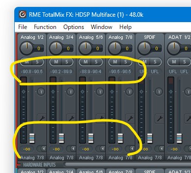

Thank you for your comment. That's right! After I posted the image, I also noticed that channels 7 and 8 didn't have the latent noise like the other channels. This is simply because the LoopBack setting for channels 7 and 8 was turned on, resulting in a different image from the other channels. When I turned that setting off, I was able to confirm that all analog channels had latent white noise. The noise is a small amount of white noise, and even when monitoring at normal volume levels, a hissing white noise can be heard. I've tried replacing the electrolytic capacitors and coils in the vicinity, but I'm starting to think that one of the IC chips on the circuit board might be broken. I was wondering if anyone on this forum has experienced the same symptoms.
The image I uploaded this time is not from the AE with white noise, but rather from the analog input on a regular Multiface I used to use. With this one, no white noise is audible, and the reading is around -90dB.

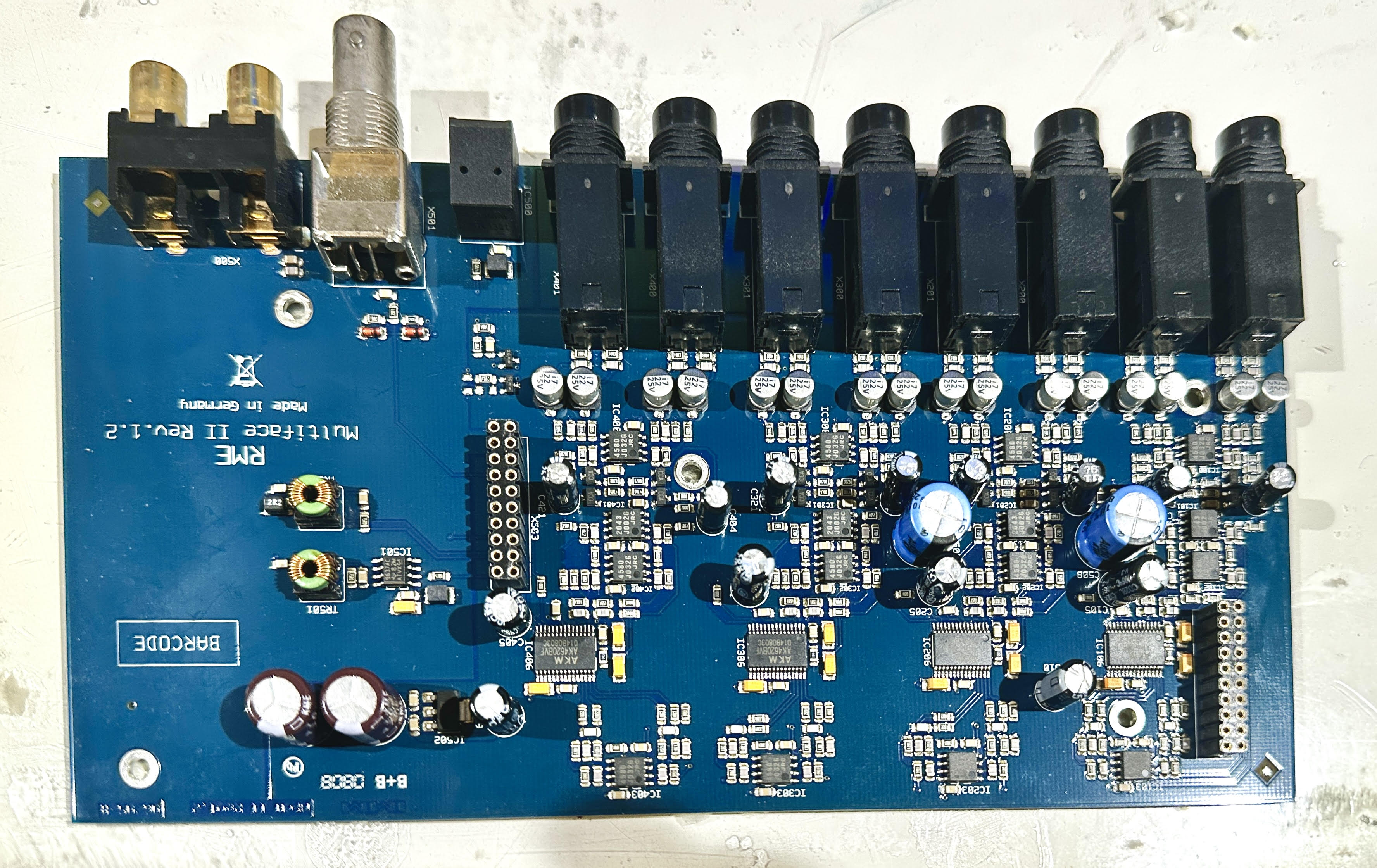

My symptoms might be the same as those described in this topic. It seems there's a problem with the upper circuit board. I'm curious about the exact location of the problem, but it's fortunate that the affected area has narrowed down a bit.
Professor Daniel Fuchs, could you tell me which chip it is? Probably not... Germany is so far away from Japan.
https://1993.jp/tmp/RME_up.jpg
Since this happened due to aging, I suspect it's related to the electrolytic capacitors. Because it affects all 8 channels, it's likely a component that impacts the entire analog input.

1) You must have pretty old TotalMix... As TM indicates loopback activated by orange dot already for a year or two, or even more. Time passes fast.... There is no orange dot indicating loopback on channel Analog in 7/8.
2) Even if loopback is activated, TM shows state of incoming signal, not the loopbacked. So, activating loopback should not change what TM shows on given input...
