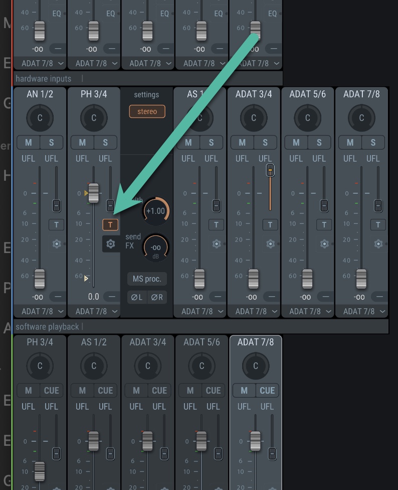

For recording it over Loopback you have to route the signal from software playback 3/4 to an output.
Your screenshot shows there is no signal.

Yes there si no signal, because it only shows in PH 3/4 (that seems to go direclty in the main), but the signal was here and heared.
I use Loopback when I want to record Computer sound to sample or else, I know how to use it, but in this case I can't catch it.
PS : maybe relaod the screenshot as I modify it cause first versions didn't show the signal at all.

There is a routing from PH3/4 to output Adat 7/8 but the signal is not visible. This is not goo.
Try record channels 7/8 in the DAW
Also there is Trim active, I would switch that off for a test.
And you could upgrade Totalmix to the new version 2

Ihave the problem today also (as almost each day ^^)
I really can't rec it, it's not in the 7/8 loopback, and I don't want to make à "physical" loopback.

Did you switch OFF the Trim on software playback channel 3/4 ? It has to be OFF.
You have to make a proper routing first, then recording will be possible.
For replacing the old Babyface I would look at the Babyface Pro FS first.
ADI-2 series devices are not real recording interfaces and don't have Totalmix.
https://i.ibb.co/5x5C1HrQ/trim.jpg

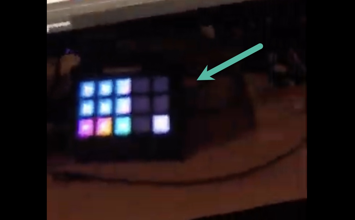

There is this Loop-player remote device connected, if you disconnect it for a test...? Looks like 10 loops are playing ?
I agree to Kubrak, the sound is not produced by the interface, the interface works correct and just plays what the computer sends.
https://i.ibb.co/RpG7V1tg/loop.jpg

The device that you point is only a Streamdeck, that I used for my shortcuts. It's not generating any sound.
I know its not generating sound by itself but may be it has a midi hanger and let play partially a loop from Ableton... ?
I would try disconnect it for a test anyway just to sort it out.

If the 2 .exe I've disabled at sartup don't work I'll try it, but I really use it a lot so I'll wait for this test to end first.
I'm 100% sure it doesn't have any midi mapping, and issue occurs even with Abelton not opened, but it may be it's audio manager exe (it's one of the 2 that I disabled at startup)

I have the problem right now.
I've unpluged the streamdeck while issue occurs, but no change sad
PS : I have no floppy disk since long time now ^^ but it would have been a fun rootcause.
