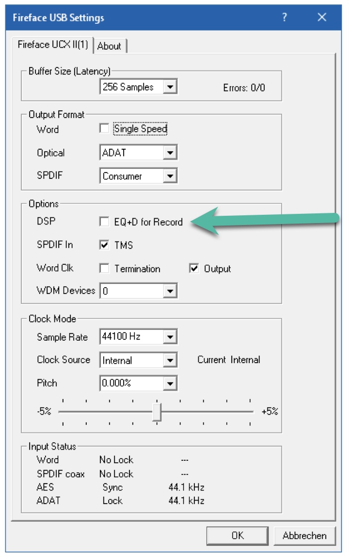

Compressor and EQ in Totalmix is for monitoring not recording unless you switch ON in the driver settings.
I can follow your request but I think it will not work. The gate will cut out the sax too much, the result will be a salad you don't like.
There is no gate in Totalmix, you would have to tweak the compressor to act somehow like a gate. But it does not really.
