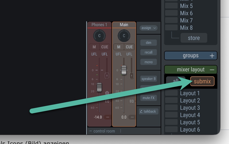

Re: TotalMix FX 2.1 released
Trommeltotti wrote:
to make the respective channel routings graphically visible
The button SUBMIX in the mixer layout does that.
https://i.ibb.co/Zpy8LQg3/submix.jpg
