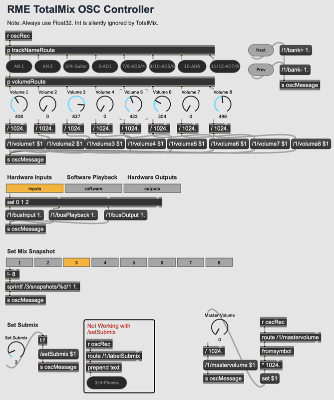

In this order of events:
1. Send something to TotalMix via OSC from Page 3, like mix snapshot
/3/snapshots/%d/1 1.
-> TotalMix returns with page 3 feedback (Reverb/Delay, DURec, Snapshots, etc.) {Expected}.
2. Then, send
/setSubmix %f
-> Here, TotalMix returns page 3 feedback again! {Unexpected}
-> Also note, some of the indices don't return any feedback. Example:
/setSubmix 1.
might return OSC feedback, but
/setSubmix 3.
does not, then
/setSubmix 4.
does return.
3. Send a Page 1 OSC command like
/1/busOutput 1.
-> Here, TotalMix returns page 1 feedback.
4. Then, send
/setSubmix %f
again.
-> This time, TotalMix returns with page 1 feedback! {Expected}
This appears like a bug to me.
Its not a dealbreaker. But on a platform like RME that seems so rock-solid and perfect, having a bug doesn't feel very nice.
Here is my test Max patch that is sending these values over.
(I am trying to put together a prototype for a hardware OSC controller. TotalMix and TotalMix Remote are absolutely amazing, but the lack of tactile knobs is causing me grief and stress in live and studio sessions).
https://i.postimg.cc/SxM7D9kn/Screenshot-2026-08-16-at-21-20-37.png
Happy to share any info if required.
