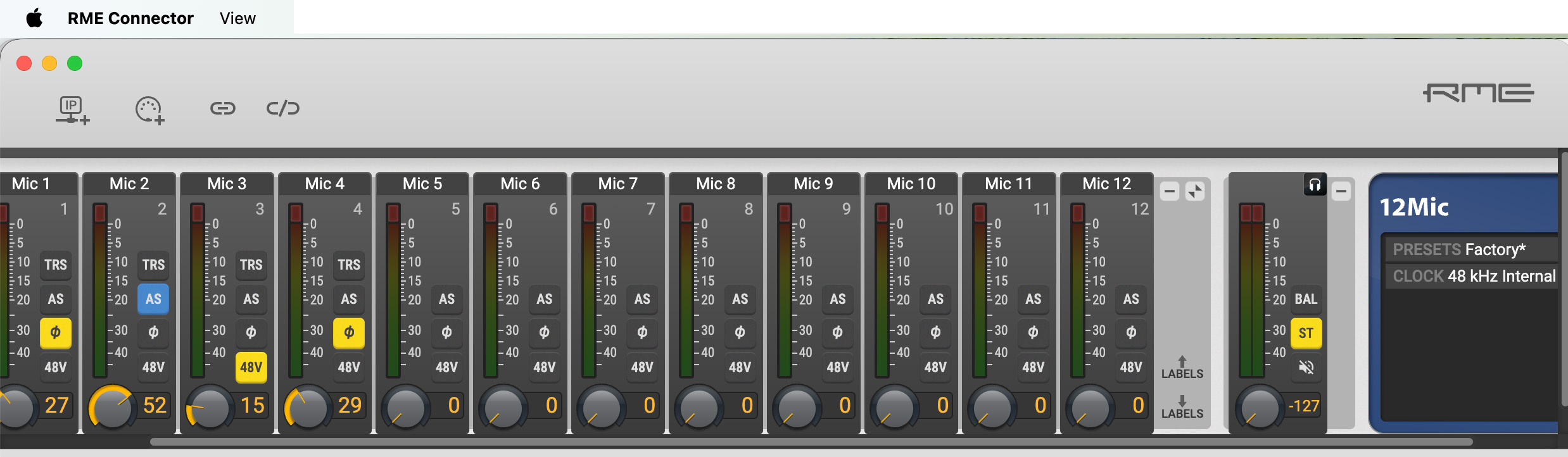

fantast999 wrote:
Thanks for clarification!
But it`s confusing - isn't it? I really would expect, settings at the 12mic being reflected in TM and vv.
If somebody controls remotely the settings he can't be sure whether the actual mix is correct (here batter and resonant in opposite phase) or not...
I think I will really step back from the MIDI over MADI option and only use presets at the 12mic.
Anyhow - thanks again to all contributions / contributors.
Did you try out Connector app ?
It is beautiful and comfortable...
Also it can store and load presets if you still need.
https://i.ibb.co/dsDFCw22/connector.jpg
