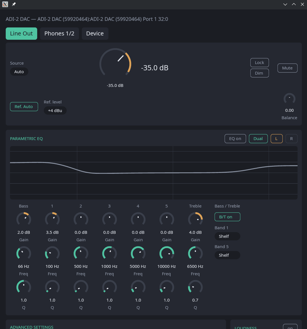

Re: rmediy-rs: a (very) lite RME remote like for Linux
Here a first test of a GUI
