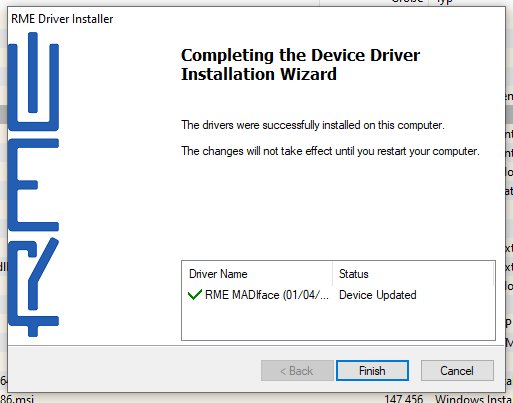

Re: Madiface driver does not install
I don't understand many things here, too many unanswered questions.
First:
Have you ever seen this window?
http://www.rawac.de/bilder/RME/Complete_installation.jpg
This is the windows at the end of the installation. At the end of running rmeinstaller.exe. Before you are asked to restart the system.
Second:
Does the file C:\Windows\System32\madifaceusb.exe exist on your system?
If Yes:
Please connect the ADI-2 DAC to the system with an USB cable. Switch it on.
Third:
Do you see the message >USB Mode active< in the display of the DAC after the RME?
If Yes:
Fourth:
What happens, if you double click the file  C:\Windows\System32\madifaceusb.exe now?
Does the RME icon appear?
http://www.rawac.de/bilder/RME/RME_Icon.jpg
Maybe you need to expand the ^ to the left of the existing icons.
Ralf
(ADI-2 Pro FS with Dell XPS13 and Dynaudio Focus 600 XD or Focal Clear — and a lot of Jazz)
Thank you for your advice:
First:
No, this has never appeared, and I have never been asked to restart my system after installation.
rawac wrote:
Second:
No, this file does not show up in a file search.
That seems to indicate you never started rmeinstaller.exe. Can you post a screenshot when that installer starts and shows its first window?
Thank you Matthias,
Unfortunately I am unable to take or post a screenshot like that, because after I run the installer (and give permission for the installer to 'run'), there are no windows. A 'loading' window appears for .5 seconds two times, so fast I can only read a few words (C+, minimal, Microsoft, runtime, 2015, config, a few other words), then nothing happens.

Thanks for this clear statement. So the installer starts but then never shows its first screen, which means nothing got installed.
This brings us back to post 7 where rawac explained what you have to do after extracting the driver files. You did not react on that one, it seems.
