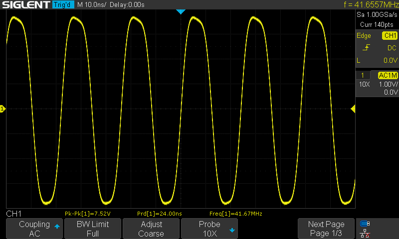

Finally I measured between pins 5 (output) and 4 (GND) of the canned crystal oscillator marked as 25 MHz and got the following:
https://s1.directupload.eu/images/250516/ej4bimfs.png
I got 41.66 MHz instead of the nominal 25 MHz! Also, Vpp seems excessive since the oscillator is supplied with the "5P" voltage. Maybe there is some odd resonance?

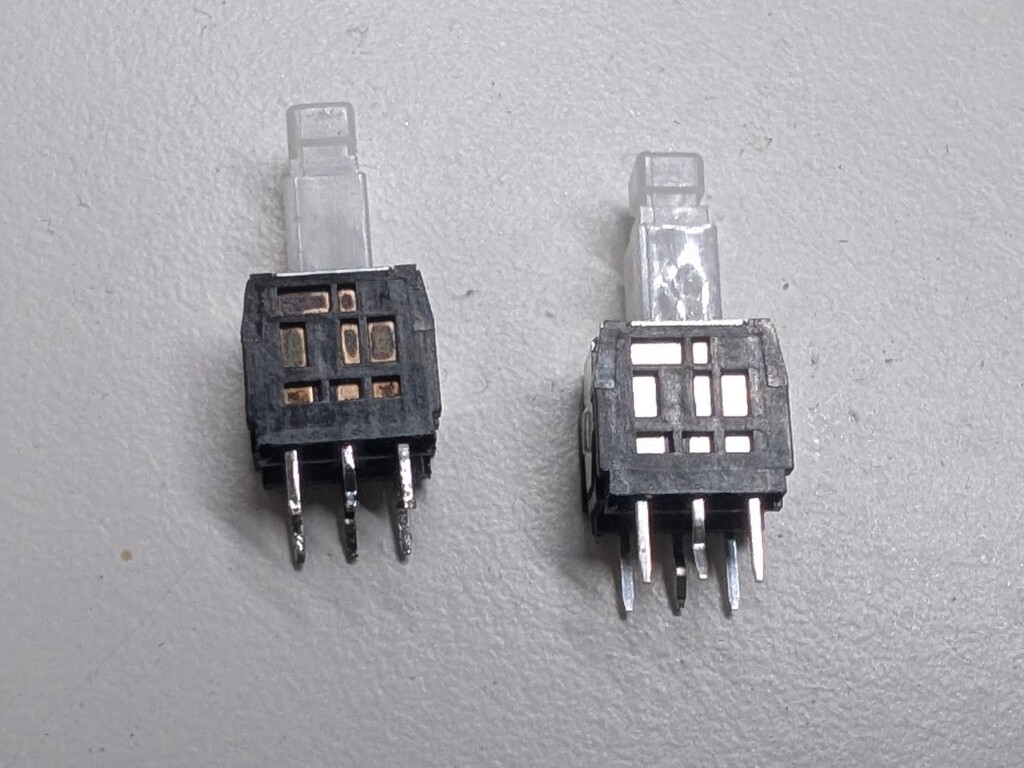

Another fix: I have noticed that the front panel switches all tended to double- or even triple-strike, making operation of the ADI-2 cumbersome. However, I also managed to find a replacement for these: Alps Alpine SPPH430200 are an exact fit. These are momentary switches rated for logic-level loads.
https://s1.directupload.eu/images/250523/ggqgfcbc.jpg
Comparing the new switch (on the right) with one of the old ones (on the left), one can easily see why the old switches malfunctioned: They are heavily oxidized. With the new switches, each single press is now recognized as such again.
