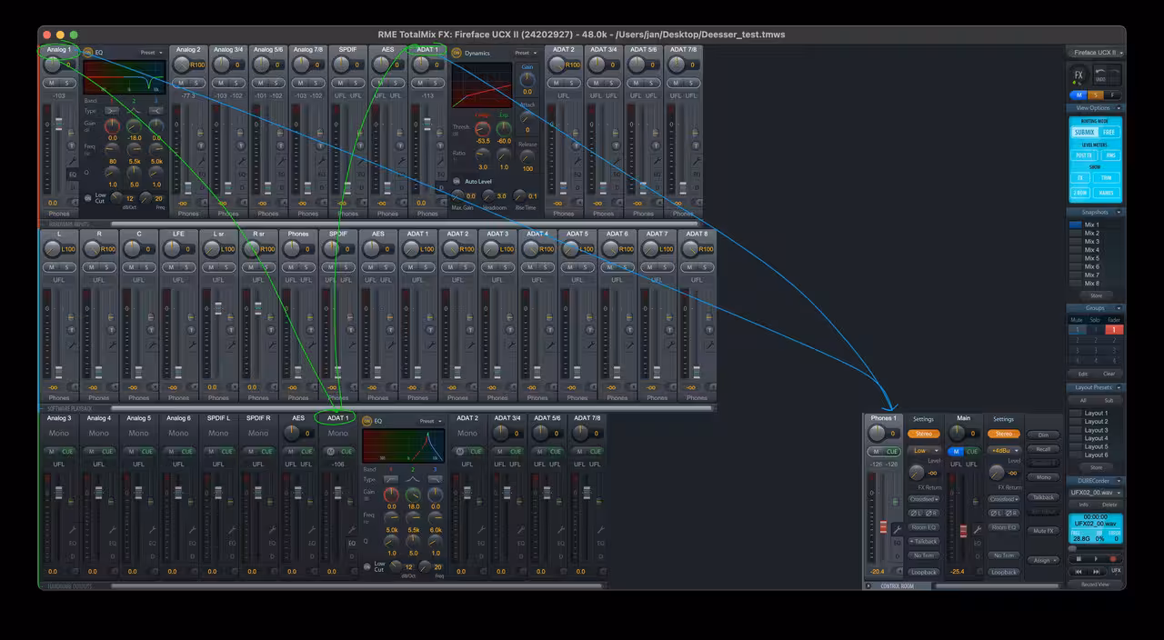

14 (edited by jpoulsen 2024-08-29 08:38:01)
Re: Deesser in Totalmix FX
Hi Folks, it seems to work fine, I just have to dial in the fine details. I'm no expert in compressors and eq's but does this make sense for a starting point:
https://i.postimg.cc/yY1dK7nG/temp-Image-Cn-Yacj.avif
