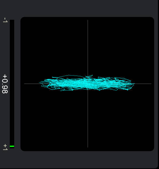

It would be greatly appreciated in a future upgrade that M/S decoding be displayed in a vertical orientation the same as non-M/S decoding.
At the moment one is vertical and the other is horizontal, makes a lot more visual sense to both be in the same orientation.
See the images below displaying the current state.
https://imgur.com/a/BlWMp4K
Thank you

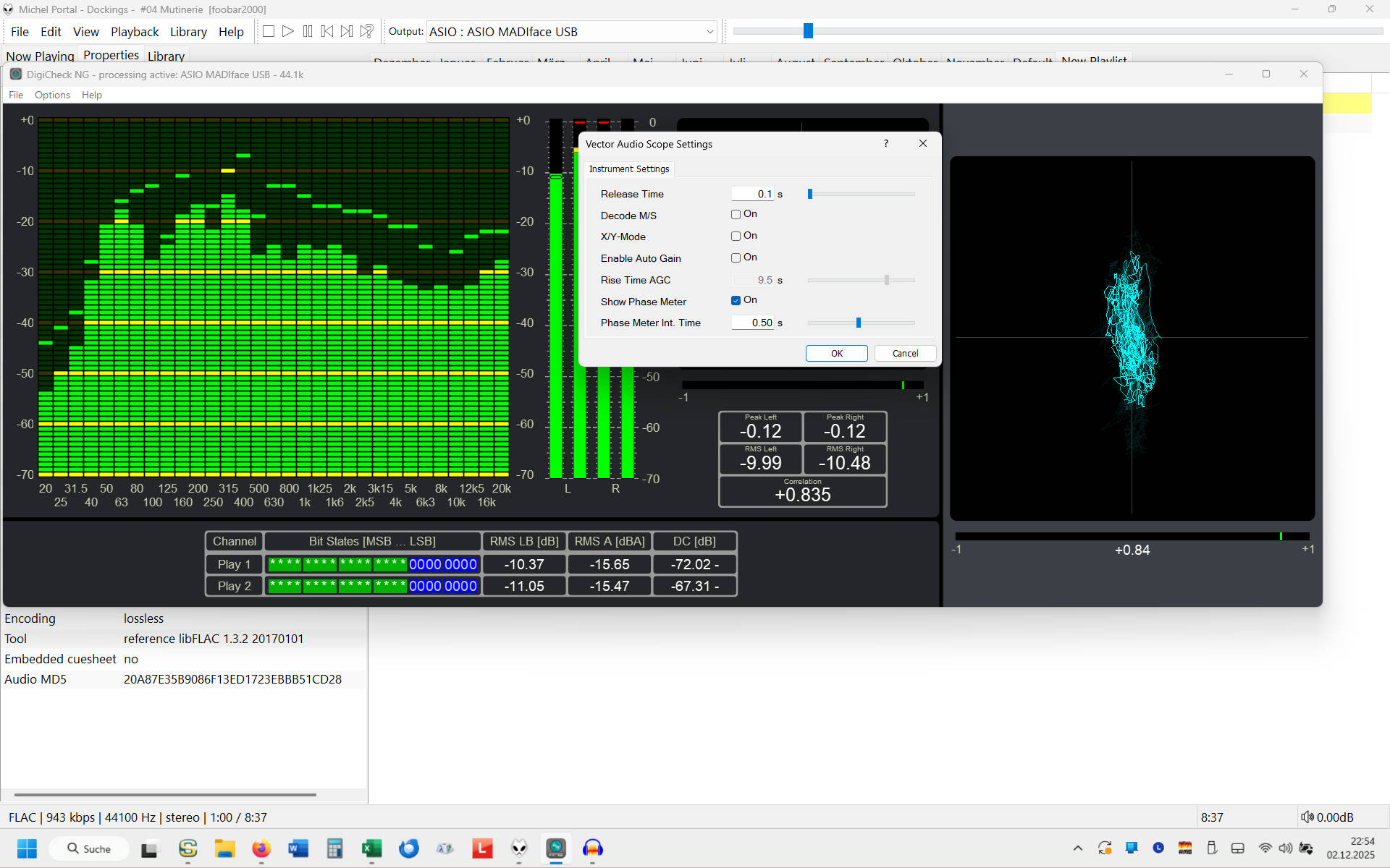

I don't understand what is wrong.

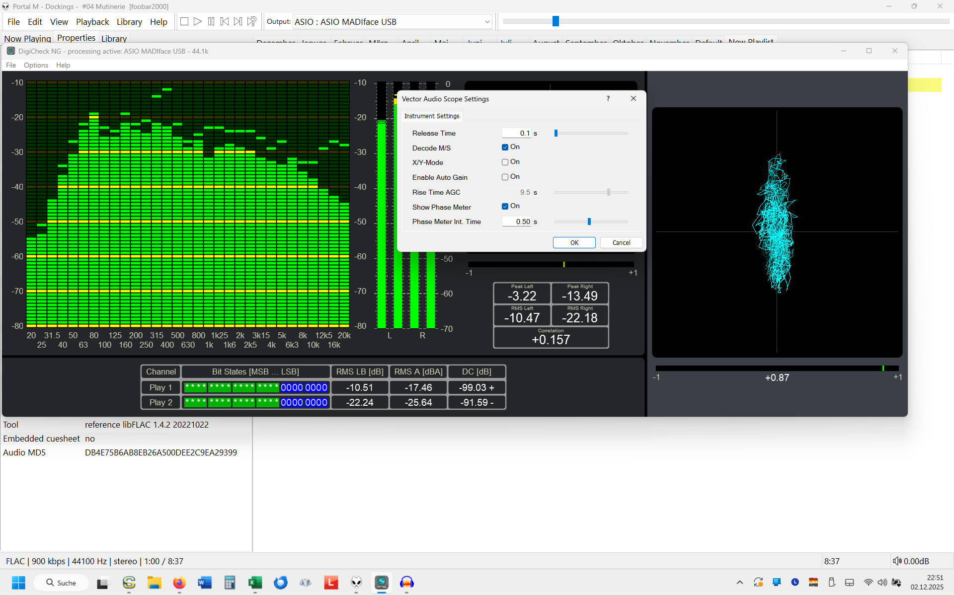

I listen to a track from Michel Portal, Mutinerie, from Dockings.
This is left/right signal as usual. Screenshot at 01:00.
http://www.rawac.de/bilder/RME/Links_Rechs.jpg

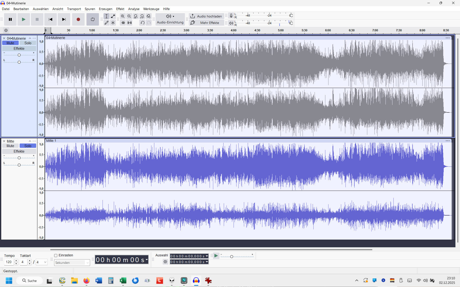

Then i generate a file, same take, with middle/side signal.
http://www.rawac.de/bilder/RME/Mutinerie.jpg
Top, grey: left/right signal
Bottom, blue: middle/side signal
Switch the Vector Audio Scope [Decode M/S] to ON.
Listen to the modified take.
http://www.rawac.de/bilder/RME/Mitte_Seite.jpg
It's not easy to hit the same time exactly.
But the orientations of the Vector Audio Scope are the same.

What you have done rawac is create a stereo file out of the m/s content, hence the vertical orientation during playback. If you setup your DigiCheck with the same layout and settings as mine (see first post) and playback stereo content you will be able to replicate what is happening to me.
Note: im not seperating m/s content, my layout is for viewing stereo and m/s content at the same time from a single audio file / source
Ive replicated the Michel Portal, Mutinerie, from Dockings at the 1min for your reference. See the below image.
https://imgur.com/a/6HpXiHS

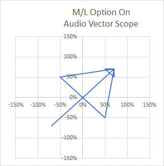

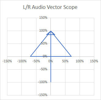

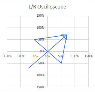

If you send the two signals to a normal oscilloscope, L to the horizontal axis and R to the vertical axis, it shows a diagonal line when L = R, i.e., correlation = 1.
http://www.rawac.de/bilder/RME/AVS1.jpg

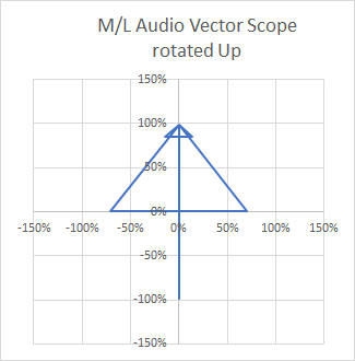

In the case of an M/S arrangement, however, M = vertical axis and S = horizontal axis, a vertical line is created from the center (M changes, S remains 0).

GolfPutter wrote:
Regarding the X/Y mode, humans don't think in 45degree angles they think in left right and up down. Audio faders are left and right not -45degrees and +45degrees. Having one scope in vertical and the other in horizontal is jarring both visually and mentally.
As GolfPutter already wrote, this fits better and is more intuitive. What comes from the center is displayed as coming from above.
That's why, in Audio Vector Scopes, the oscilloscope tube was rotated by 45° (before the digital age), which was easy to do mechanically, but is stupid in a digital device with a pixel screen. It is easier to leave the screen normal and calculate the rotation.
http://www.rawac.de/bilder/RME/AVS3.jpg

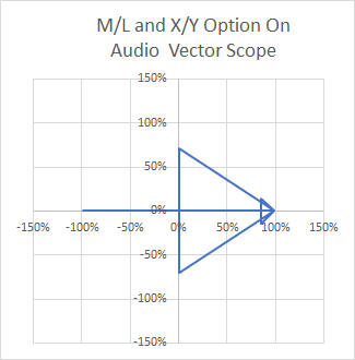

If you switch Digicheck setting [Decode M/S] to On, the graphic rotates 45° back.
http://www.rawac.de/bilder/RME/AVS4.jpg
If you absolutely want the classic oscilloscope display, for whatever reason, you can switch on [X/Y-Mode]. DigiCheck then sends L to the horizontal axis and R to the vertical axis. If you enable [X/Y-Mode] too, it rotates another 45° more.

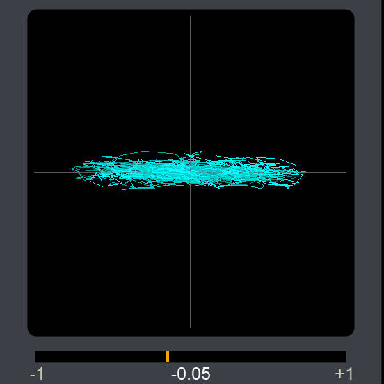

If RME would fulfill the above request to turn this up, the result would be:
http://www.rawac.de/bilder/RME/AVS6.jpg
Absolutely identical to L/R Audio Vector Scope (see above). In my opinion, makes not really sense. If 2 Vector Audio Scopes do display different shapes from the same input, it's because other options in the Audio Vector Scope Settings are different.
In the first screenshot from GolfPutter the shapes are equal:
http://www.rawac.de/bilder/RME/AVS7.jpg http://www.rawac.de/bilder/RME/AVS8.jpg
Only the calculation of the correlation -0.05 goes wrong, because Digicheck uses the formula for M/S input, but the input is L/R.
