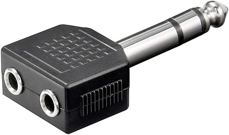

... It’s strange why a much cheaper DAC like Mojo can provide two headphone out for shared hearing, the much expensive RME cannot..
Please read the manual. Chapter 8.2 IEM Phones Output explains, why RME has incorporated this more complex and expensive feature.
The Mojo solution is the same as what such an adapter does.
