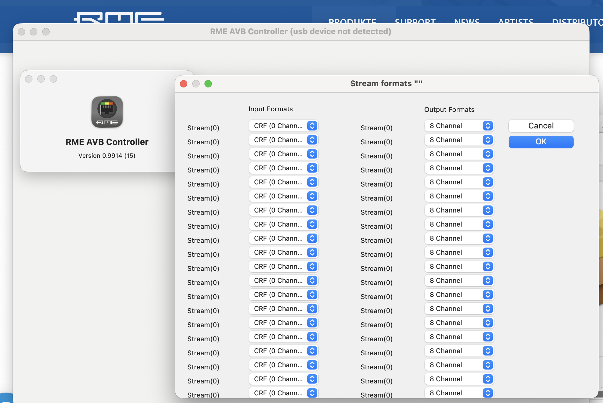

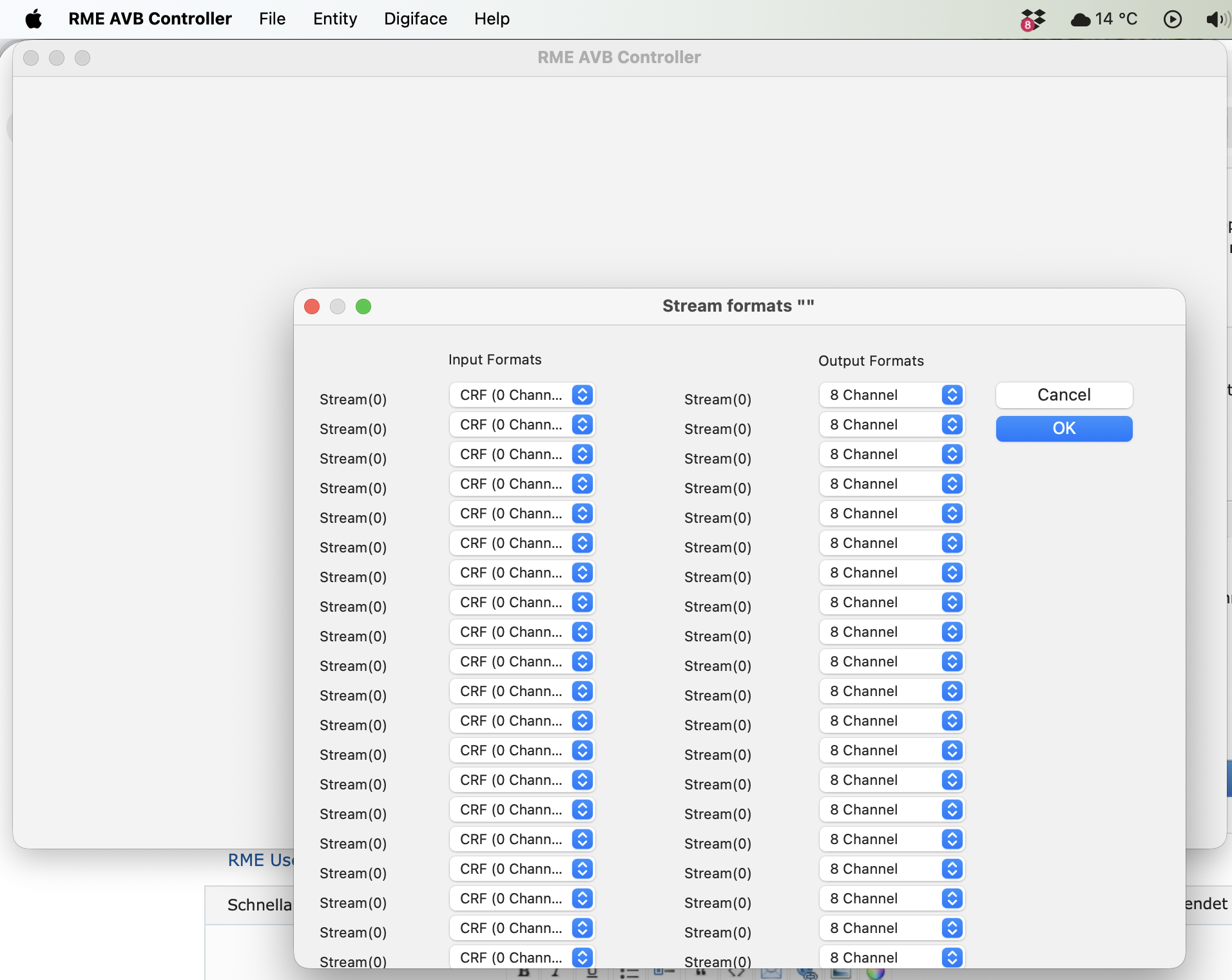

Re: No UI showing in AVB Controller
No USB device connected
https://i.ibb.co/HD8L1g1Y/avb.png
From the headline of the main window I conclude that you are not useing the lastet version 0.9914. But you did find a minor bug: the dialog should not open if there is no device available or connected.
Yes it was 9574, I redownloaded the AVB package and now it is on 9914, same behavior of course,
https://i.ibb.co/4nCtw2xP/avbcontroller.png
