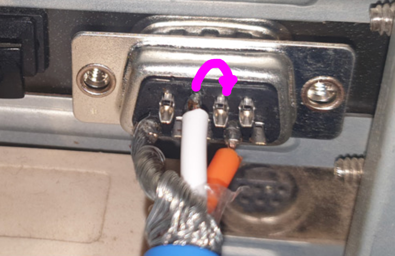

I have a vintage RME hdsp 9632, and I can't pull out AES/EBU from it.
However, optical output works well.
I made a custom 110 om xlr cable according to the user manual. And it seems that the output settings are correct.
So, most likely, the problem is with the cable.
But I can't understand what exactly is wrong.

Just from your image it seems at the D-sub connector the white wire is at the wrong place, it should be one position to the right ?
https://i.ibb.co/jZwPqhhp/pin.jpg
https://i.ibb.co/Fbs9rMMK/pin.jpg

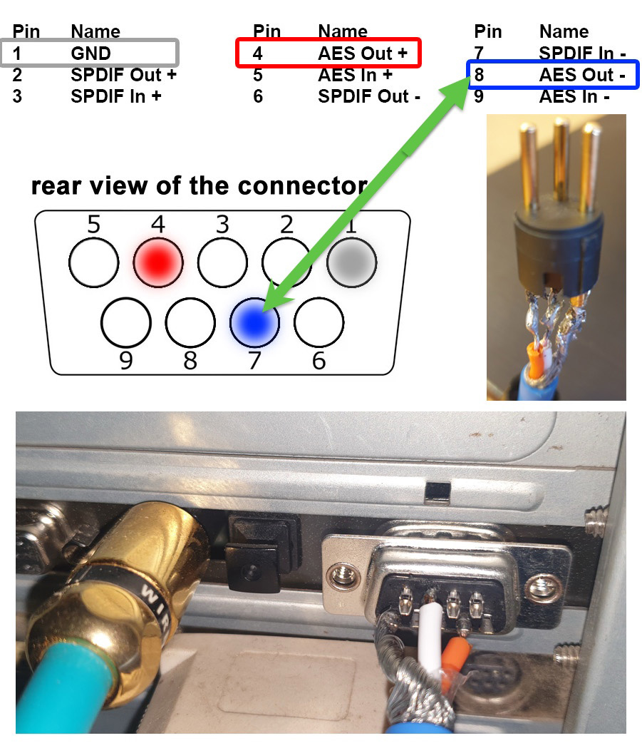

Re: Problem with AES output from HDSP 9632
Yes, easy to overlook
I added numbers to the plug for more clarity.
https://www.dropbox.com/scl/fi/pooohmt1 … 3&dl=1
https://www.dropbox.com/scl/fi/pooohmt1wu232hj79ew0n/2026-01-15-AES-Pinout-Cable.jpg?rlkey=ye08jyvlvklfa7lj8ftqzkfg7&st=3k5hc3p3&dl=1
Very nice, I was too lazy
rear view and also flip upside down is a lot of imagination work at once.

Omg, I hope it's just consequences of festive days..
One wrong move in Photoshop turned everything wrong way.
Thanks a lot guys for your attention and help! Now the SOUND has appeared!
