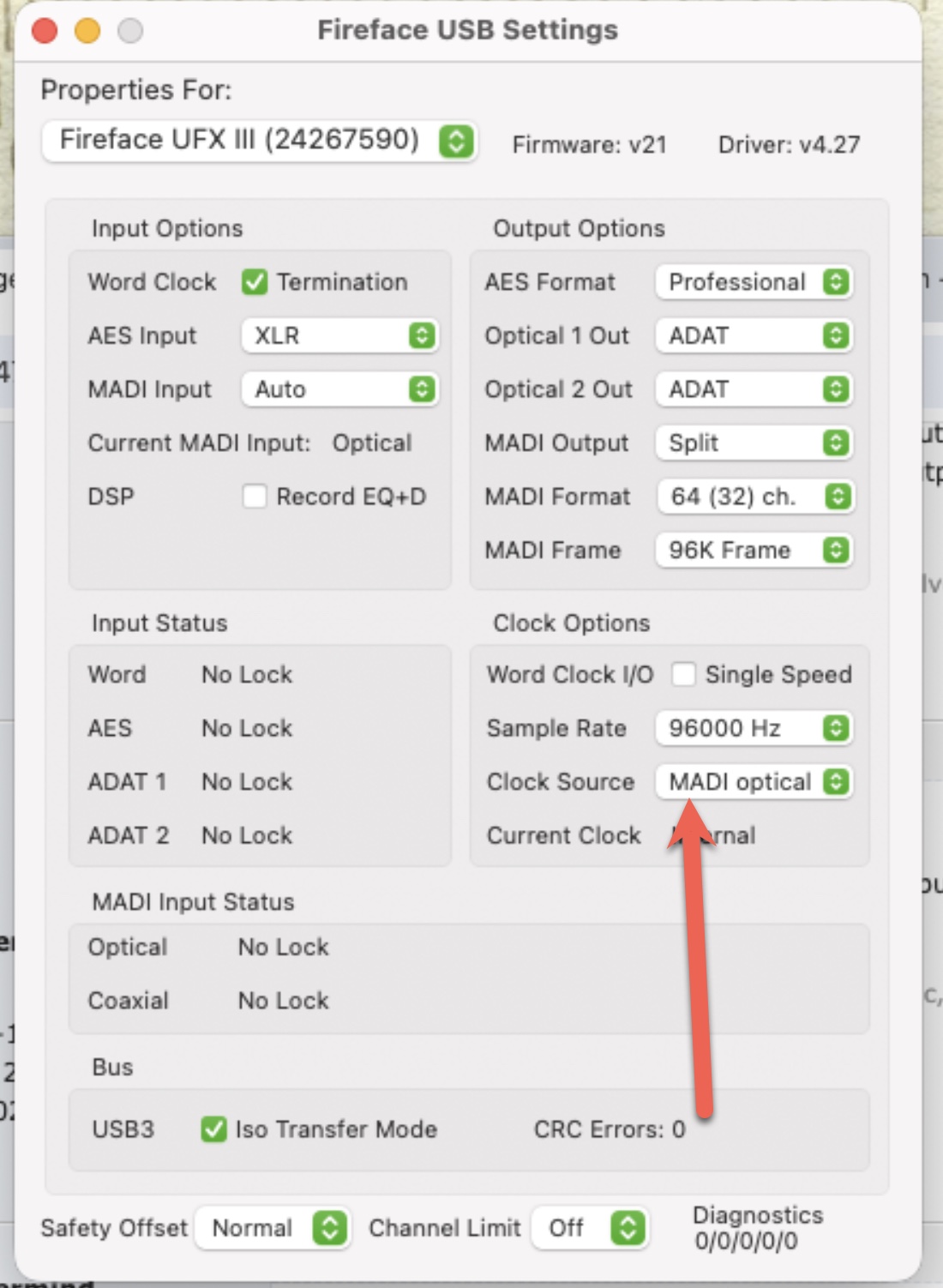

Fireface USB Settings:
https://www.dropbox.com/scl/fi/m1umprnj … i&dl=0

In the Fireface USB Settings dialog make clock-source internal not Madi input
Or do you have some Madi equipment connected ? In the Cubase settings you did set it to internal clock.source.

Why is clock-source Madi optical ?
Re: Asio driver problem!?

RamoTeder wrote:
there are Madi output only 3 ways:
optical
mirror
split
I tried with all of these, same!
Your answer has nothing to do with the clock-source in question
Make clock-source internal
in the Fireface USB Settings dialog
https://i.ibb.co/rGcfN98t/internal.jpg

@Ramo: you can't simply select a digital input of your choice (like e.g. MADI) as the clock source if there is no device connected that delivers a clock signal over the digital link. In a typical "one device setup" you need to use the internal clock as source.
More information regarding clock synchronization you can find in my blog:
https://www.tonstudio-forum.de/blog/ent … ios-en-de/

Without proper clock settings you might get clock issues over time (clicks, ..) it doesn't explain that "nothing works".
But you should simply set it proper.

In Fireface USB Settings dialog :
Clock-source internal
There is no more or less proper setting.
The clock setting has to be correct for all devices connected digital.

Then the clock setting is correct.
There must be something else.
I just did a test.
RME driver 427 and CubasePro15 works fine no problem.
