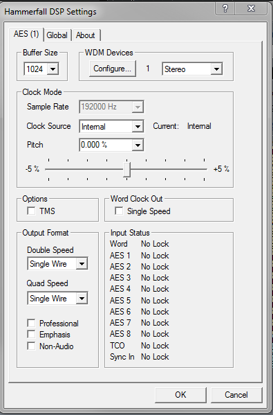

The problem: I don't hear anything coming out of the speakers, nor do I see anything coming into the card. D/A state is blinking and the "Input status" of the Hammerfall DSP Settings is "No Lock". I switched also to other sample rates, no success.
Here are screenshot of my Hammerfall DSP Settings

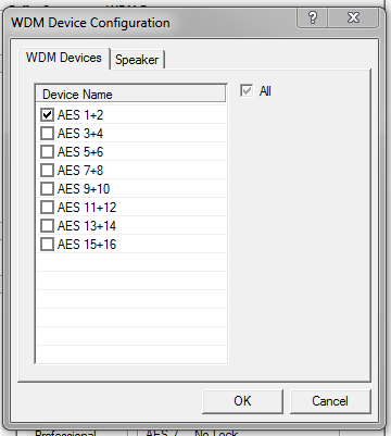

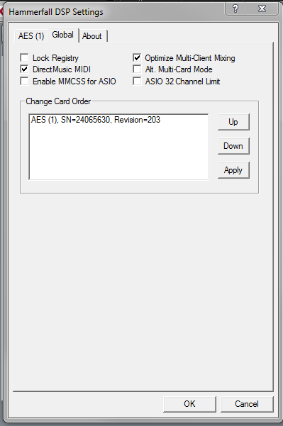

My Raydat card worked like a charm it was intuitive, but here I really don't know what I am doing wrong. I must admit that I did not understand the WDM section, I don't know if the default factory settings are correct for my setup.
Any help would be appreciated.

The whole Word stuff is unnecessary. Both ADIs can perfectly sync to the incoming AES signal if set up correctly.
The fact that zero signal is shown in the card's input status makes clear that your cables are not AES Tascam cables but something different. Or you plugged them into the analog DB25, instead of the digital one (the upper one).

Okay I used the wrong cables! I have the correct ones now and everything works fine now!
Also removed the wordclock, it is not necessary.
