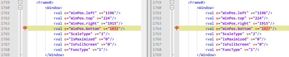

I noticed that the window height increases randomly by a few pixels every time after a restart. To capture this change, I backed up a copy of "last.BabyfacePro1.xml". After several restarts, I found that the "WinPos.bottom" parameter has increased:
https://i.ibb.co/Rpfmgy6Z/2026-03-29.png

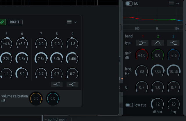

Regarding the scaling, it would be nice to have the ctrl+scroll function active in the RoomEQ window as well. Some recent change made the REQ window very small and unable to scale up when simply making the window larger, on the biggest size the font size and knob size isnt consistent with what I have in the main window:
https://i.ibb.co/CpLysMsx/image.png
also, when I move the REQ window onto a screen that has different system scaling (window spawned on 150% scaling monitor, moved it to 100% scaling monitor), it suddenly looks quite aliased:
https://i.ibb.co/bM95GCsL/image.png
