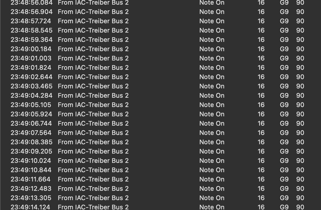

414 (edited by waedi 2026-04-11 23:01:32)
Re: TotalMix FX 2.0 – first beta available for macOS (now released)
Nothing changed, BabyfacePro no fader output (aswell Digiface USB) but UCX ll yes.
But Note on command from TM nonstop
https://i.ibb.co/qLWd61QL/midi.png

Waedi, come on…
The messages your screenshot shows are the Midi  loopback detection. Described since a few years in every units manual.
Again: Check your settings.
Again again: This midi stuff here is not TM 2.0 related at all.
Believe me or not. Midi works in TM 2.0 exactly the same way as it always did.
“Do It For Her”
thanks, you are right, the only thing I pointed out is the difference of BabyfacePro and UCX ll in offline mode sending fader pitch wheel values.
