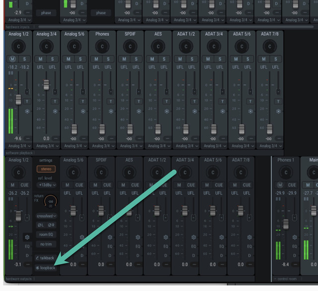

How do I feed playback audio down the line (zoom, nexus.source-elements.com, Google Meet, etc.) in TotalMix 2?
Using Reaper.
Screenshot is showing playback in Reaper on Analog 1/2 (software playback section).
Thanks.
https://i.imgur.com/LUr2Xb9.png

Just trying to playback audio so the person on the other end of the call (zoom, etc.) can hear the playback. I can hear it but they cannot.

Switch ON Loopback in output 1/2
https://i.ibb.co/Vcxvkdyx/loopback.jpg
Re: Feed playback audio down line
And THERE we go. Thank you!
