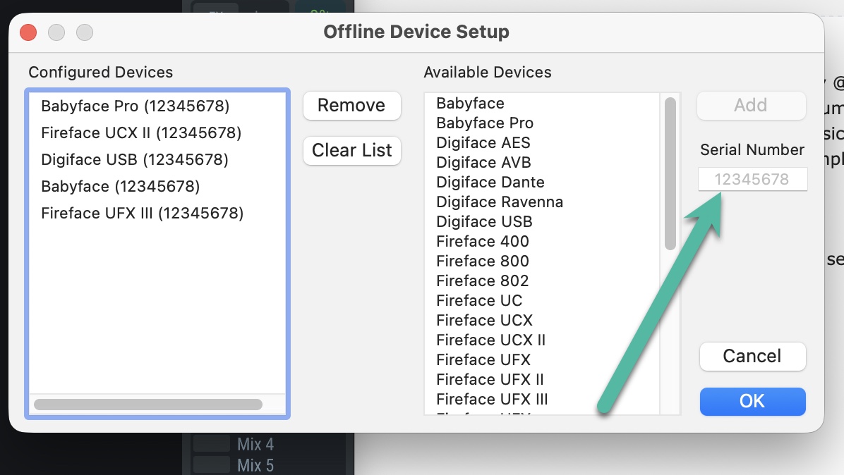

I have to take back my upper comment´in post #6. Demo devices should and do work as expected by @asperine. But one important point has been overlooked: on Mac the dialog to generate the offline device has the option to add a serial number. Here one has to use the serial number of the online device. Then everything will work with Workspaces. Manual editiing the file is basically possible, but includes the serial number in several places, which most probably was overlooked as well so the Workspace loaded incomplete. As said, better do it right from the start.

I never used workspace editing with offline device, but good to know.
I'm convinced this serial number input was overlooked.
https://i.ibb.co/0RZmPZMg/serial.jpg
