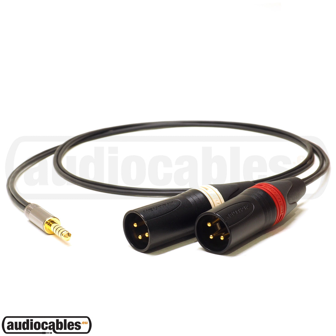

BTW: With a Pentaconn to 2x XLRm balanced interconnection you can achieve a 6 dB higher level.

Consider the ifi Pentaconn-to-XLRs cable that ifi offers as spare:
https://shop.wodaudio.com/produkt/ifi-a … DqEALw_wcB
https://shop.wodaudio.com/wp-content/uploads/2021/03/ifi_44-XLR_1000_580_1.jpg
Less expensive:
https://www.audiocables.eu/products/mog … cbn2M7_kOk
https://www.audiocables.eu/cdn/shop/products/MogamiBalancedCablePentacon5polesTRRRSto2MaleXLR_1100x.jpg?v=1654452329
