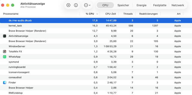

Hi, i am running MacOS Tahoe 26.4 on an Apple Silicon M4 Mac
I noticed the "de.rme-audio.dkusb" process always runs as the hottest process in activity monitor
above all other tasks and apps and is between 17-21 (!) % of CPU drain.
(please see attached screenshot)
i am running a Babyface Pro FS with latest driverkit 427 and also latest firmware i can find on the rme website.
and i just updated from MacOS Tahoe 26.4 to 26.5 but that doesn´t make a difference.
i first thought Brave Browser is the issue but it doesn´t matter if i close the browser or with any other
app that processes audio.
Is this a known issue?
https://i.ibb.co/99JbBmWp/c-PU.png

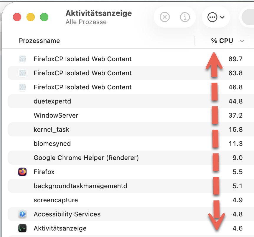

The issue is the wrong  interpretation of the activity monitor by the user.
The % number is the % of the working process of one CPU core.

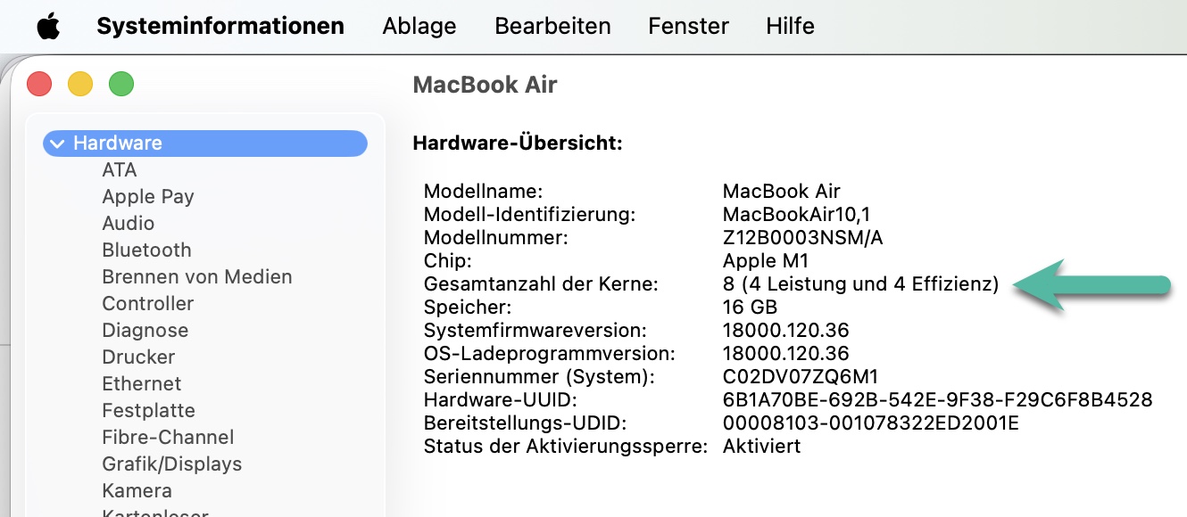

How many CPU-core has your computer ? Open the Systembericht.
My MacbookAir has 8 cores
https://i.ibb.co/p607JJVf/core.jpg
Your computer has that much power left that the system is able to offer 21% of working power of one core to the RME driver at the moment.
You are fine.

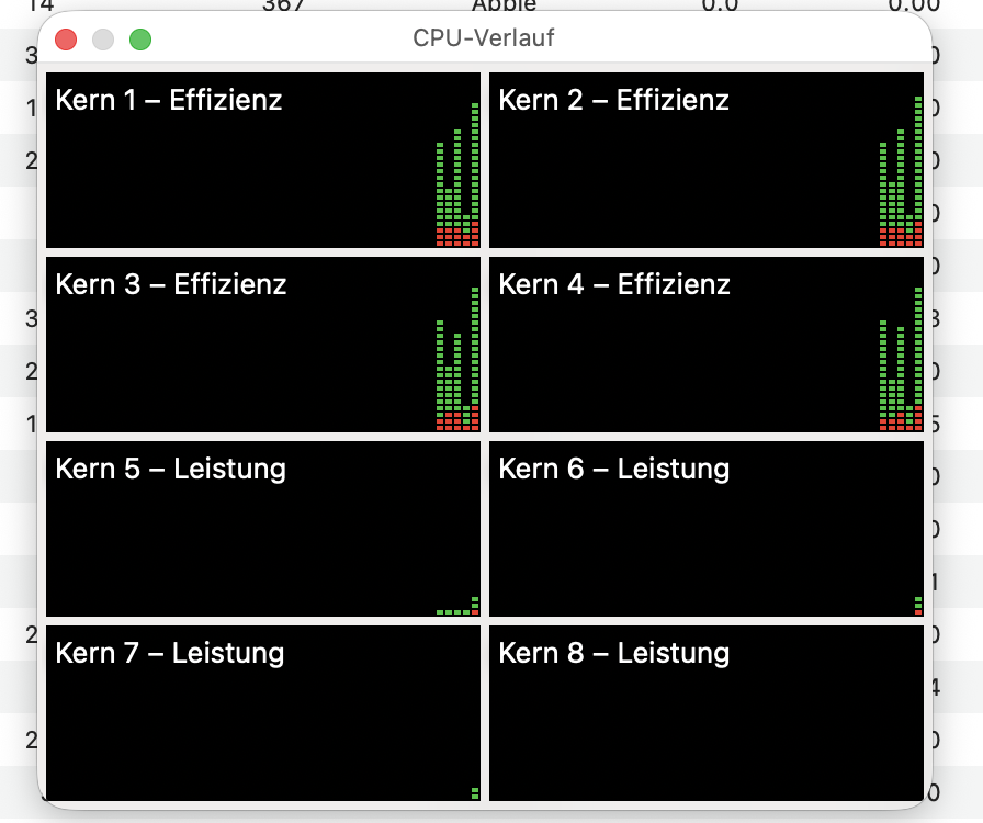

With activity monitor open hit command 3, it opens another window with each core workload history
https://i.ibb.co/KxxWhQ72/cores.png

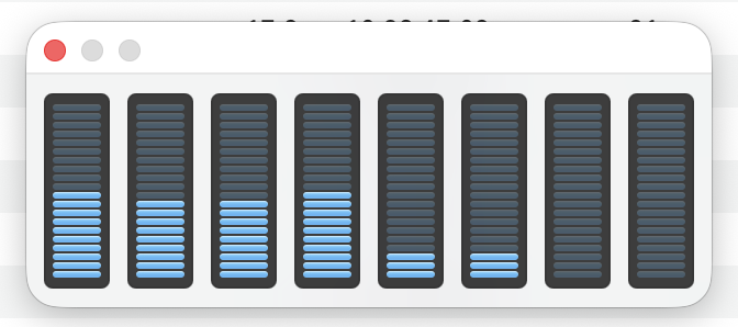

In the activity monitor hit command 2
It opens a window with real time processor load for all cores
https://i.ibb.co/LX3LsYXy/realtimecpu.png
The list of the applications % cpu is real-time.
It is often misleading to the user who think one of his software does occupy a lot of the CPU system.
"Oh shit my computer is not powerful enough, I must run to the Apple store and buy more Macs"

i didn´t say or think that my mac is running out of CPU.
But the relation to other processes and their CPU drain is noticeable.
For example i switch to another Audio driver it only has 7-9% CPU.
Also the Apple Coreaudio driver sucks here 8% when just playback a simple mp3 file
vs. RME driver with the same task use more that double around 17-20%
However, i can live with that - i was just curious if thats normal.
980
Re: Mac USB driver for macOS 11 & Apple Silicon hardware
In case you talk about internal playback - yes, a 2 channel hardware will cause less CPU than a multichannel one - not to mention the different hardware connection.
@ramses: waedi is right, and we repeatedly have to explain to Mac users how to read the numbers correctly.
