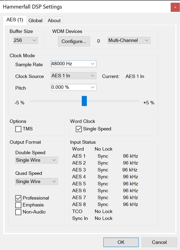

I wanted to document a behavior I encountered with the HDSPe AES card that others in a similar signal chain might run into, and ask if there is a known solution or planned fix?
Signal Chain
JRiver Media Center (bitstream or PCM, WASAPI HDMI out) → Trinnov AltitudeCI-10 (HDMI in, decodes bitstream and passes PCM to 10 channel AES out) → RME HDSPe AES (AES in, clocked to incoming signal, ASIO to AES outputs) → 6x Xilica XD4080 4in8out DSP processors → Benchmark AHB2 amplifiers → speakers and 8x JL Audio Fathom subwoofers. 29 total processed channels, with 5 bed speakers actively tri-amplified.
The Behavior
The RME Hammerfall DSP Settings window exposes sample rate and clock source as ComboBox controls, but the RME driver conservatively sets its sample rate to half the incoming AES rate rather than matching it directly. This is after I set Clock Source to follow "AES 1 In"... So for example, a 88.2kHz on AES 1 In from the Trinnov AES outputs results in the Hammerfall DSP running at 44.1kHz, and 192kHz on AES 1 In results in 96kHz for the clock source (despite the inputs at the bottom of the window syncing to the correct rate from the Trinnov). This means the RME sample rate must be explicitly set to match the correct output rate for each piece of content as it will not auto-follow the incoming AES clock. For now, I had to write a AHK script to do this, and it works, but I'm curious if this is a known bug.
Question for RME
Is this expected behavior, and if so is there a setting or API that would allow the HDSPe AES32 to automatically follow the incoming AES clock rate without requiring manual intervention each time the sample rate changes?

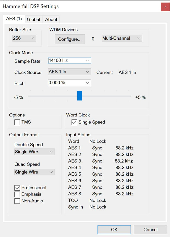

Before the Trinnov Altitude CI my signal path was:
JRiver Media Center (WASAPI, HDMI out) -> RME HDSPe AES32 (ASIO AES out) -> Xilica XD4080 DSP processors -> Benchmark AHB2 amplifiers -> Speakers
Now after adding the Trinnov it has now been extended to:
JRiver Media Center (WASAPI, HDMI out) -> Trinnov AltitudeCI-10 (HDMI in, decodes or passes PCM, 10 channel AES out) -> RME HDSPe AES32 (AES in, clocked to incoming signal, ASIO to AES outputs) -> Xilica XD4080 DSP processors -> Benchmark AHB2 amplifiers -> Speakers
The Trinnov Altitude CI is more than capable of outputting AES (regardless of the digital input being used to receive the original signal). https://www.trinnov.com/en/products/altitudeci/
It outputs AES as it is in a pro-audio home theater application. HDMI is needed to connect the PC and the Trinnov as the Trinnov performs immersive format decoding duties (something that cannot be bitstreamed over AES or Dante).
In my use case, the Trinnov Altitude CI is the AES master, and it sends its AES outputs directly into the RME HDSPe AES card.
The AES inputs in TotalMix are then sent out the AES outputs of the HDSPe AES card to the individual speaker processors (Xilica XD4080) which take AES in, do time alignment and filtering, then output an analog signal to amplifiers.
HDMI irritates us all smile, but it is a necessity here. The fact remains that when I play a 44.1k or 48k file, HammerFall sets the displayed sample rate correctly to match that of the AES Input that indeed syncs just fine with. However, once anything above 48kHz is played, HammerFall has to have it's Sample Rate manually set to match.
This was done via an AHK script, but I'm not sure why the HammerFall driver works this way. If it sets Sample Rate to match the sync from AES 1 for example, why not do it for 88.2kHz or 96kHz?
https://i.postimg.cc/jS16r2zF/88-2k.jpg
https://i.postimg.cc/Zqy8YmcM/96k-sync.jpg
https://drive.google.com/file/d/1poZaNn … drive_link
https://drive.google.com/file/d/1TqBQQW … drive_link
Cabling is NOT the issue at all as I can manually set the sample rate each time (if above 44.1kHz or 48kHz), and everything is played back perfectly. The issue is clearly the way HammerFall DSP behaves. It refuses to set the Sampling Rate for a signal it has a valid Sync for on AES 1 In as show in the screen shots above.

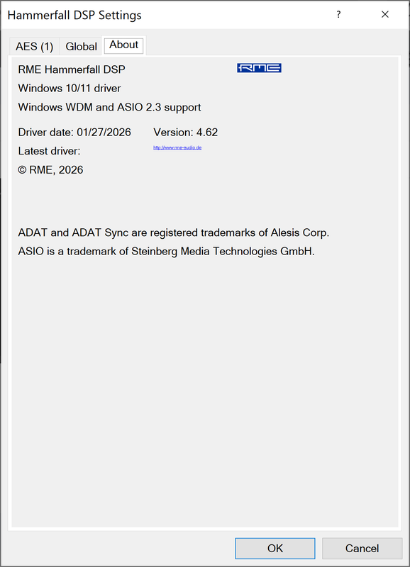

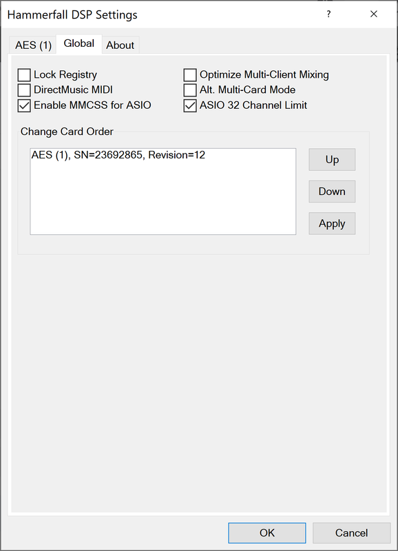

Everything is running its latest firmware and the latest drivers are being used:
Firmware and driver versions and additional HammerFall settings:
https://i.postimg.cc/GpsF3RQN/Hammer-Fall-Settings-2.png

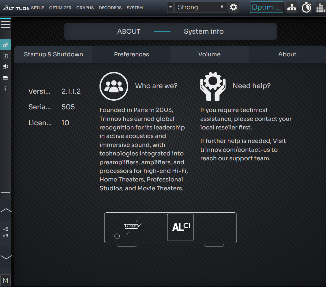

Trinnov Altitude CI version:
https://i.postimg.cc/26R4Vt9N/Trinnov-Version.png
https://drive.google.com/file/d/1hf-cAE … drive_link

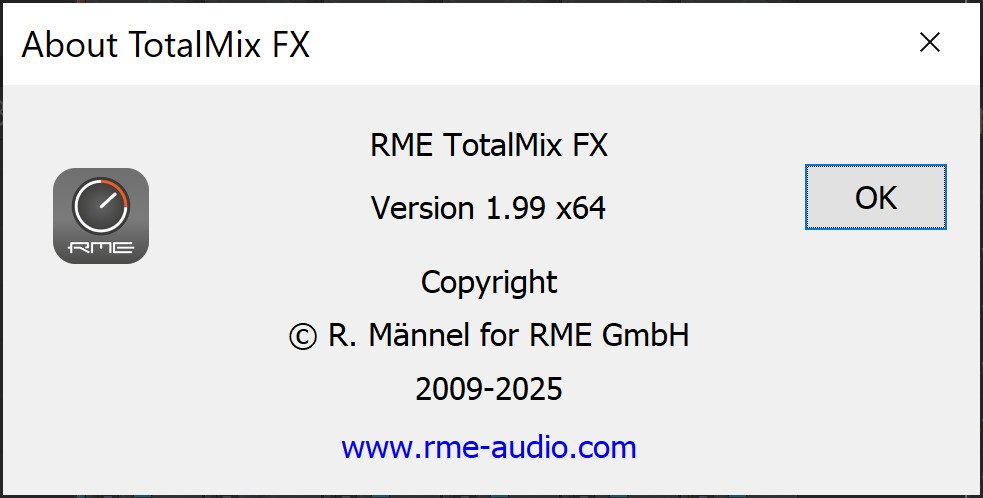

TotalMix version:
https://i.postimg.cc/rpt1yTjw/Total-Mix-Version.jpg
https://drive.google.com/file/d/1lpAAt0 … drive_link

This is fully normal and intended behaviour. The card supports double/quad wire at the input so can't know what comes in. The reference is set by the user in the app in use. We are currently discussing putting away with these old (clearly unused) double/quad wire schemes and change to Follow Clock over all sample rates. If that happens you will read it here.
Re: RME HDSPe AES Does Not Auto-Follow Incoming AES Sample Rate?
MC was a bit faster... The point is indeed the change across samples rate ranges, i.e. 48 to 96. 44 to 48 works, as you have observed already.
I'm not using an app at all. AES comes in to be monitored and have it's level adjusted by TotalMix, then goes immediately out over AES. Since only TotalMix touches the data, there is no app setting. If there is a follower setting in TotalMix, please let me know.
This is troublesome as the sample rate changes depending on the FLAC file being played. An option to follow the clock over all sample rates would be great and much appreciated.
Yoiu seem to mix two different ways of working into one. Follow Clock to an external signal as is the topic of this thread, and changing sample rates with projects or files in a DAW (here WaveLab) - which requires the computer's audio interface to run in internal clock mode. I have no clue how that could work when using external clock mode (with or without Follow Clock) - how does the source of this signal know that WaveLab changed to a different sample rate? How can the ASIO card controlled by WaveLab work correctly when it's synced to a different clock?
A greyed out sample rate field in the Settings dialog is clear sign that you are using the wrong lever. If an app is running in ASIO then it intentionally controls the sample rate, and it is not a good idea to overwirte this from the driver side.
Thanks Matthias!
Yes I'd like to play audio at 96k, locked to external AES clock at 96k, and then to press stop, change the external clock to 44.1k and then play and record audio at 44.1k.
Why is it required to use internal clock for this?  I'm capturing audio from the ADC and need to clock to the ADC.  I change the sample rate at the ADC, and would like the card and the ASIO driver to follow the new sample rate.   This has worked for many years with a Lynx card.  There is no dropdown or selector for sample rate in Wavelab - to my understanding it changes itself in internal clock, and in external clock gets the sample rate from the ASIO driver.  At any rate, in all cases I'd like to play and record audio at the same sample rate as the currently selected sample rate of the ADC clock.
With the RME HDSPe AES, it seems to work mostly reliably at 1x sample rate - I can change from 44.1 to 48 generally without an issue, though sometimes Wavelab crashes.
What seems to be the crux of the matter is changing to 88.2 or 96 - when I change the sample rate at the ADC from 48 to 88.2, Wavelab's sample rate indicator changes to 88.2, but the audio plays at half speed.  Upon pulling up the Hammerfall DSP Settings, it shows that the card is synced to AES 1 at 88.2 under "Input Status", but under "Clock Mode" the sample rate is listed as 44.1.  Wavelab can't play audio (or crashes) and the downstream DAC is seeing 44.1.
Similarly, when starting at 96 and going to 44.1, Wavelab sees 44.1 but the "Clock Mode" and downstream DAC sees 88.2, and Wavelab can't play. Generally going between 96 and 88.2 functions normally.
In other words, it seems as if the card "Clock Mode" isn't changing from 1x sample rate to 2x sample rate, and vice versa, though it can change from 44.1 to 48 or between 88.2 and 96.  It appears that Wavelab is receiving the new sample rate correctly, but can't play as the card is running at half or double that rate.  This seemed closely related to the issue of the thread.
