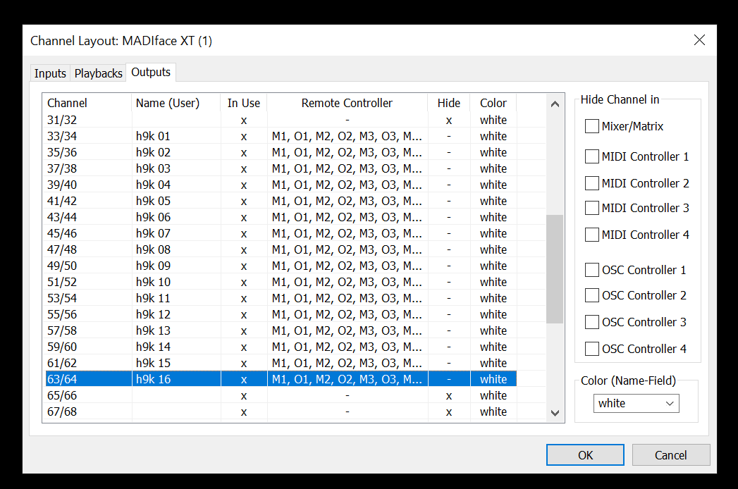

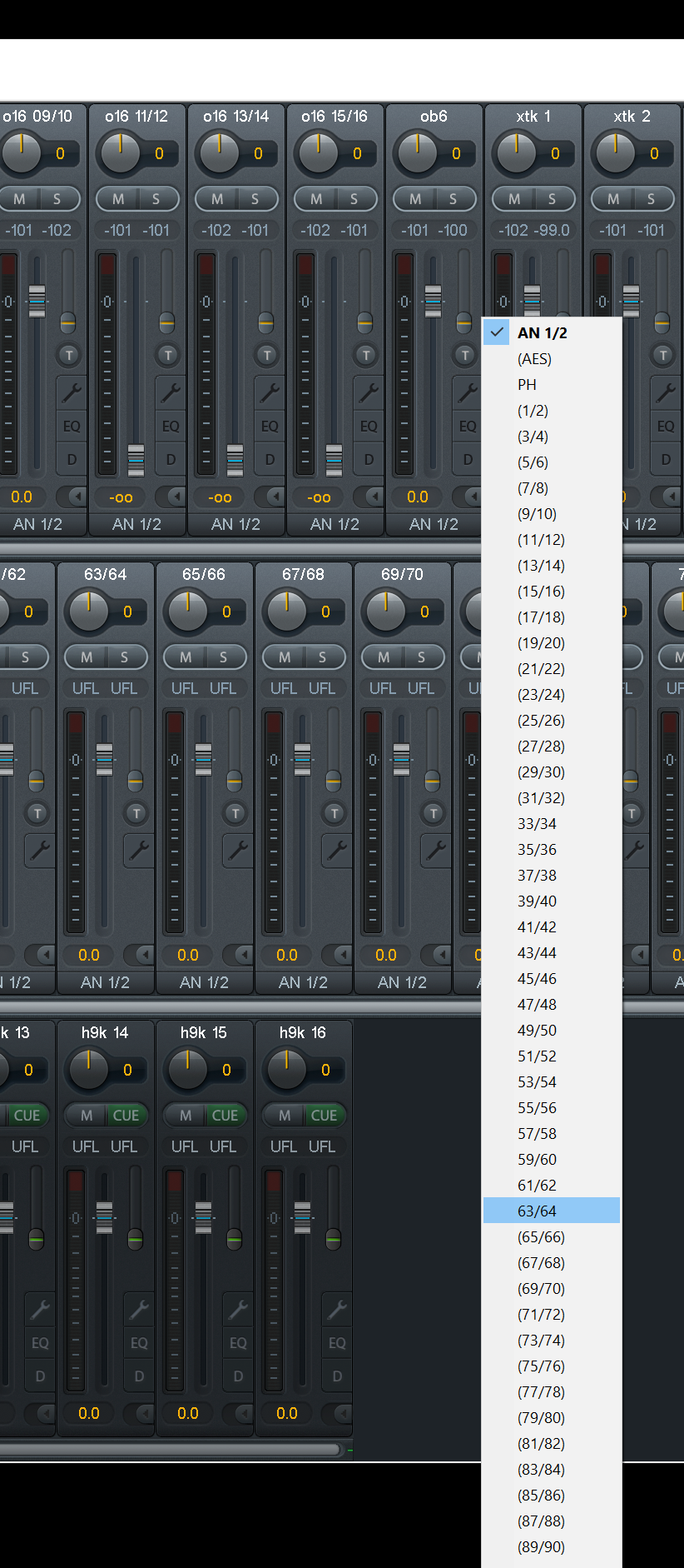

Bumping this thread. Is there a way to do this now? I captured some screenshots to illustrate the problem.
Here you can see I named channels 33-64 to align with the 16 stereo inputs on my h9000:
https://snds.gd/forever/totalmix-usernames-options.png
When I want to select the fader for these outputs, I only see the channel numbers:
https://snds.gd/forever/totalmix-usernames-mixer.png
Routing would be much simpler if the user names could be in the drop down, even if they were included with the numbers like "63/64 - h9k 16".
