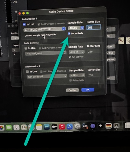

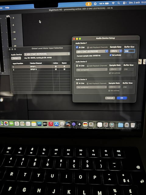

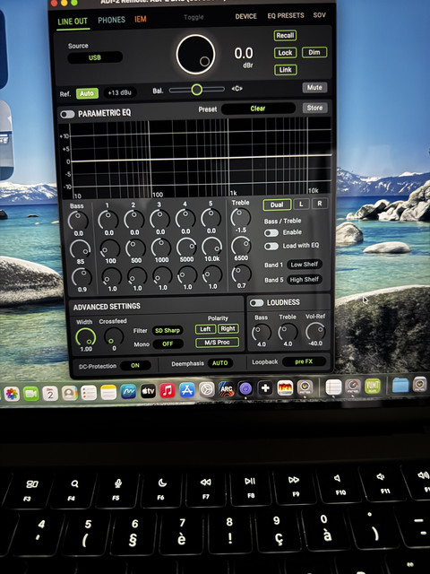

lolot500 wrote:OK, I hear all your remarks. on the one hand by reading the manual that is not really clear about it... there are passages indicating that we can only monitor the spdif in signal. and on the other hand given your various remarks it seems very logical to monitor the USB out signal through ADI 2 remote by selecting the USB source in input and activating LOOPBACK. my question is always the same: why when I open DIGICHECK the signal is cut off and why it is impossible for me to activate "add playback channels" in the "audio device setup" tab Of Digicheck.

Again, from the manual:
Note: The option Loopback to USB replaces the SPDIF input signal with the USB playback signal, either taken pre or post DSP. The input signal coaxial/optical is then no longer available for recording.
So you have to select SPDIF In L and R to see the USB playback signal in DIGICheck. There is no support for direct playback monitoring on Mac with ADI-2, so no playback channels selectable, and the exact reason we added the Loopback function.
DC NG should NOT be set to change the sample rate! Remove the checkmark at 'Set Sample Rate'. The signal 'cut-off' on opening is most probably caused by the set sample rate option in DC NG.
