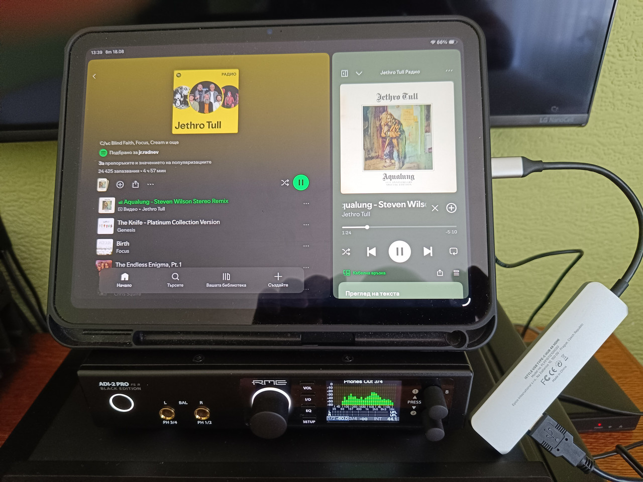

It works for me with  adapter C/A  and the stock cable. No problem.https://i.postimg.cc/hPDrxWgT/IMG-20260818-133936.jpg
