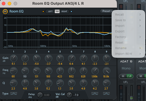

Hi,
I'm using TotalMix FX 2.01 with an UFX+ (MacBook Pro M2 Max, latest macOS).
I've imported my room correction data from Sonarworks to TotalMix FX / Room EQ and it works great.
But recently I have the problem, that I can't load / open my Room EQ presets and settings, as they are greyed out.
Anybody else also has this problem?
Thanks in advance, best

Re: Room EQ, Crossfeed, Triple SPDIF - UFX+, UFX II, UFX III, UCX II
Please update to released version 2.03.
Hi Matthias, thanks for the advise.
I've updated to 2.03 but the problem was not the version, but the old design.
With the new design selecting presets works, with the old design it still is greyed out and not accessible.
Win10 Pro 64bit v.1903 | Nuendo 10 latest | i7-4820K 3.7GHz | 32GB DDR3 RAM | RME Fireface UFX+
274
Thanks, we'll check.
