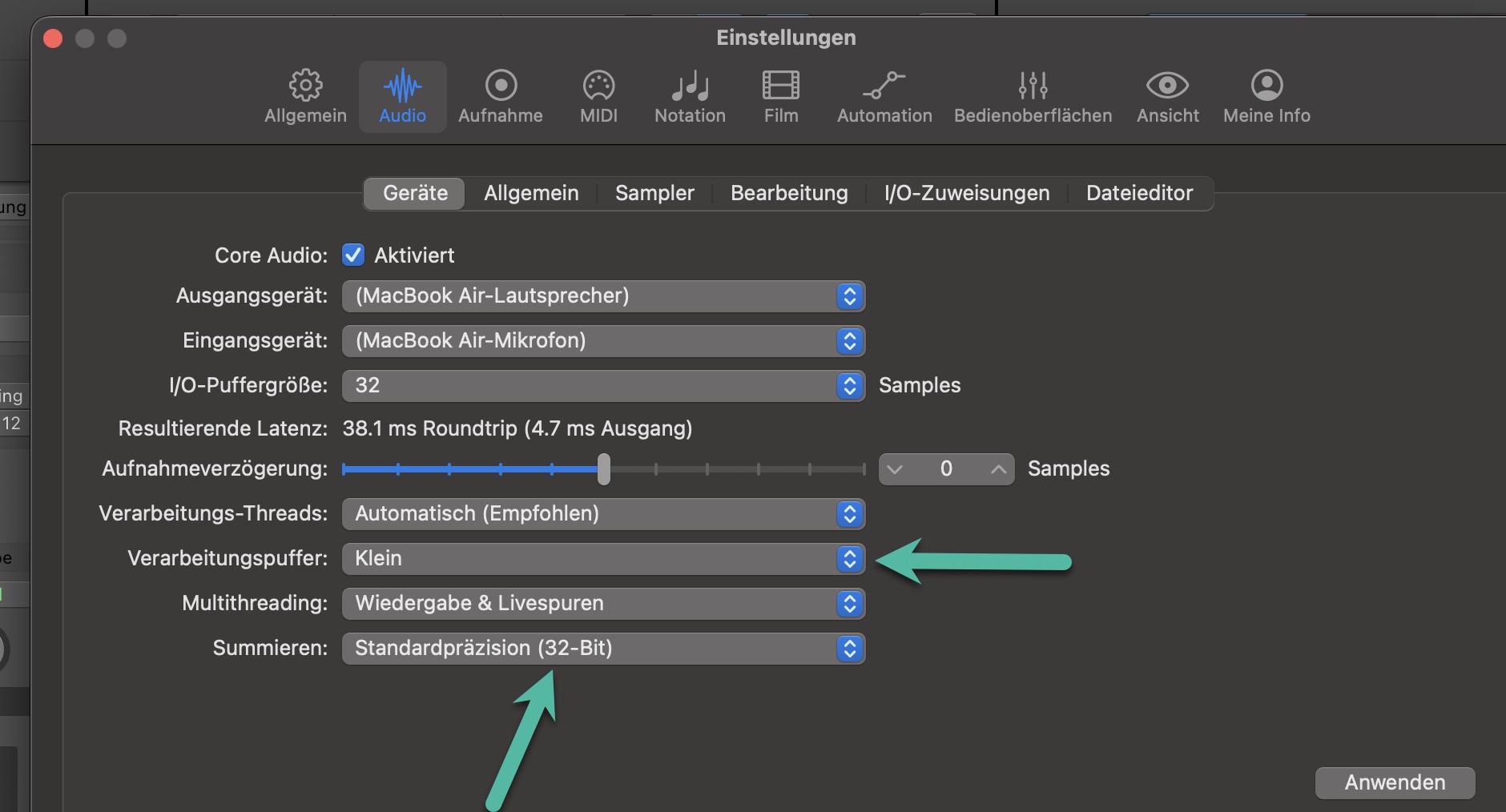

3 (edited by waedi 2026-08-30 00:36:52)
Re: HDSPe RayDAT / MADI distortion in Logic 12
The new Logic works fine, one thing I can think of is settings may got resetted by mistake.
Check the Logic audio preferences on both systems
https://i.ibb.co/GvXMJjF7/preferences.jpg
