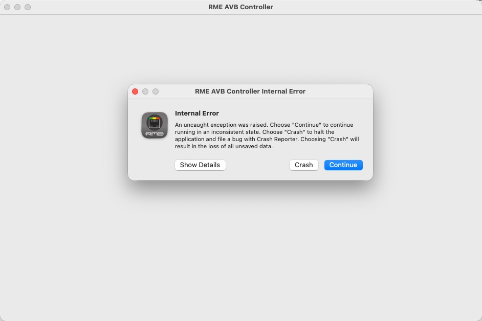

No USB device connected
https://i.ibb.co/HD8L1g1Y/avb.png
Re: No UI showing in AVB Controller
From the headline of the main window I conclude that you are not useing the lastet version 0.9914. But you did find a minor bug: the dialog should not open if there is no device available or connected.
Yes it was 9574, I redownloaded the AVB package and now it is on 9914, same behavior of course,
https://i.ibb.co/4nCtw2xP/avbcontroller.png

Also 0.9915 on my mac (26.6.2) presents an empty window (no UI) with a connected device (both USB and AVB) no matter what I try.
Firmware v272, Driver: v4.27. Driver pacakge "driver_usbnw_mac_3224" would not install because the os is too new.
Using "Entity" -> "Stream Format" presents an internal error message:
http://ingorandolf.info/Screenshot%202026-08-31%20at%2010.12.13.jpeg
Exception Name: NSInvalidArgumentException
Description: sheet <NSApplication: 0x1056394b0> cannot be attached to itself
User Info: (null)

Let me know if you are interested in the full crashlog.
