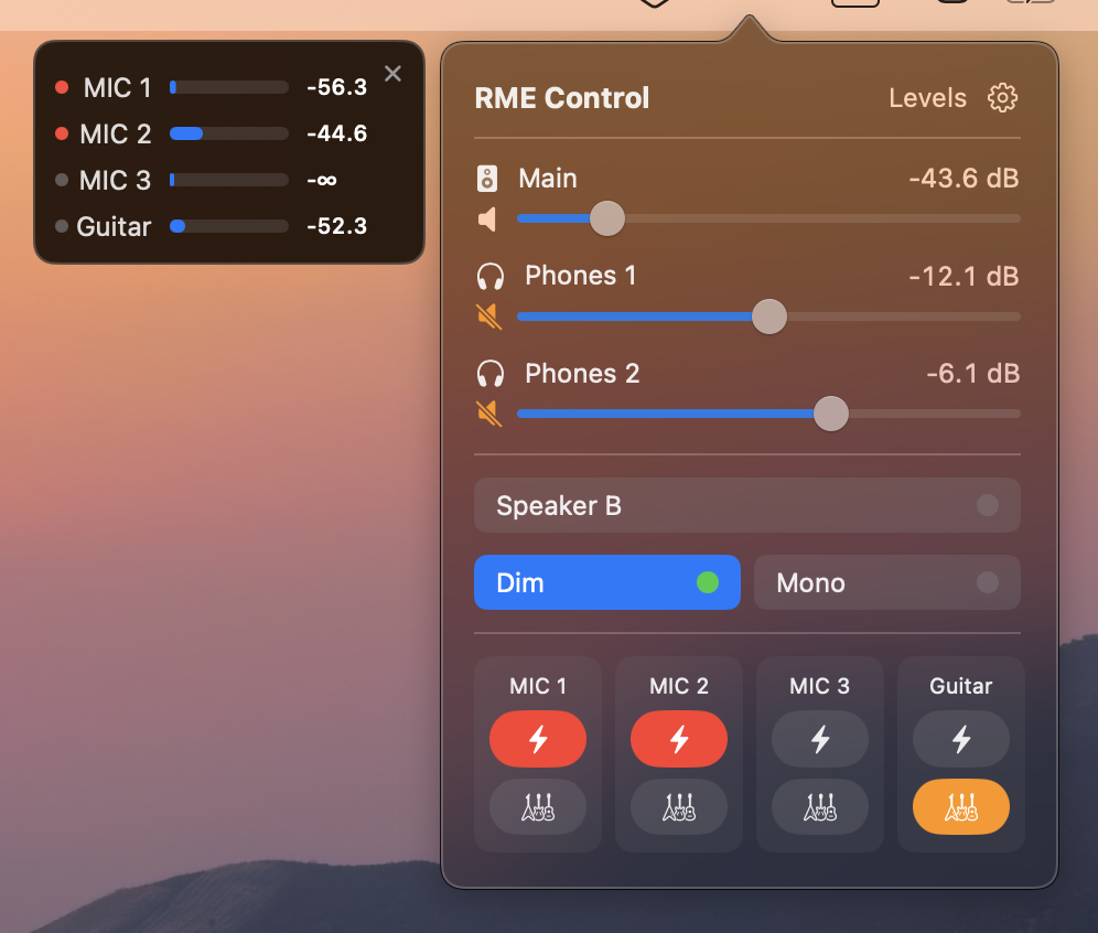

RME Control 2.6
Menu bar application for controlling RME audio interfaces via TotalMix FX.
Works via Global OSC only with TotalMix 2.1+
https://i.postimg.cc/mZHsfNQb/Snimok-ekrana-2026-08-28-v-02-19-59.png
Features:
1 - Volume control for any outputs (including Main Out and headphones) via Mac volume keys with an adjustable step size of 1–10 dB, menu-bar control, output muting, and assignable analog channels for independent routing.
2 - Dim/Mute function via the Mac mute key.
3 - Mono toggle via SHIFT+CMD+M.
4 - Speaker B button.
5 - Phantom power and instrument mode control for any number of input channels, along with input level monitoring via a dedicated always-on-top window.
6 - Clipping notification.
7 - Input and output channels can be edited and new ones can be added.
8 - Customizable menu.
9 - When TotalMix or the audio interface is disconnected, values cannot be changed; in this case, the Mac volume keys revert to their native system behavior. The application reads values from TotalMix at startup and is fully synchronized and stable.
10 - The 'RME Control Remote' block has appeared in the application settings — just flip the 'HTTP server' toggle, and the app will launch its own web server within your home network. A QR code will appear on the screen — scan it with your phone (connected to the same Wi-Fi), and you will get a full RME remote control right in your mobile browser.
Setup:
1. TotalMix: set OSC Host to 127.0.0.1, ports to 7001 / 9001.
2. OSC Mode: Options → Mixer Settings → OSC → Compatibility (Mode): Global OSC
3. Enable Send Status
4. Enable Send level data
5. Enable Peak hold
6. Enable Send all data on start
7. macOS: grant the app Accessibility permissions.
Download RME Control 2.6
https://drive.google.com/file/d/1RJJUYX … sp=sharing
Enjoy, friends!
