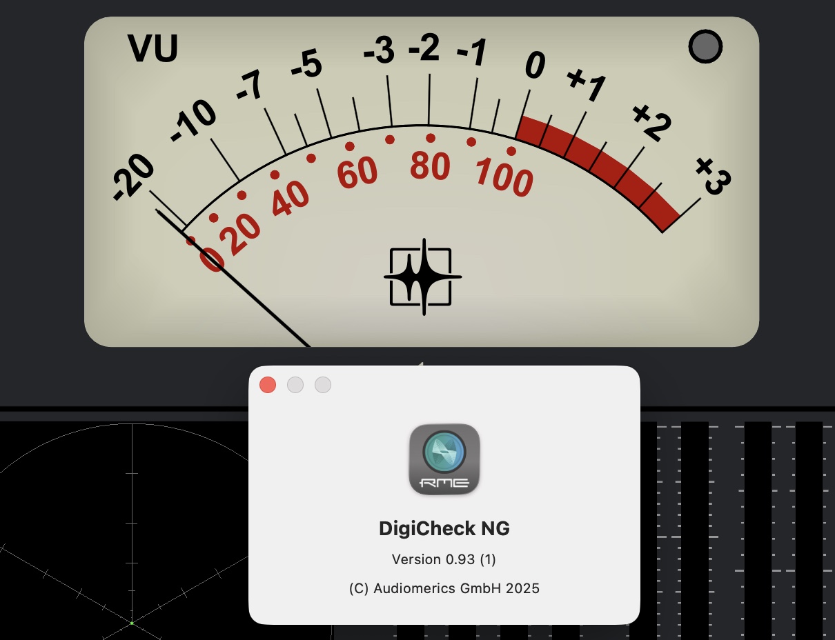

The official download page for DigiCheck NG with VU meters links to `digicheck_ng_mac_093.zip`.
Is this the official release version that incorporates the features from the previously discussed and publicly released 0.92 beta, including the VU meter functionality?
Re: DigiCheck NG 0.93 beta 5 – public preview Mac / Windows
https://i.ibb.co/60qTbvfb/VU.jpg
Thank you very much. I have been using this great feature since the beta stage.
I have one question specifically about the VU meter. When mixing, I might set the reference level (headroom) to, for example, -18 dBVU and work at that level throughout the mix. Then, when I move on to mastering the final 2-mix, I may want to change the reference level to -9 dBVU. This means I have to manually change the VU reference level.
Is there a simpler or more convenient way to set this up, for example, so that I can easily switch between these two reference levels?
