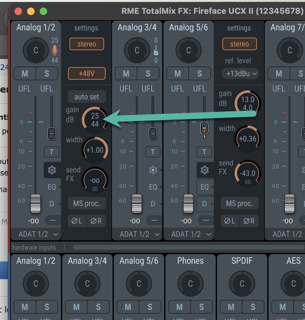

Stereo-input channel shows two numbers L/R move the mouse over one of the two numbers and use mouse-wheel or two fingers on the trackpad, set the input gain for left and right individually , no problem. And the snapshot does recall it fine.
If you may do a test : Disconnect the interface and use Totalmix offline device UCX ll and check for difference regarding your issue...
https://i.ibb.co/ynwRnBy1/gain.jpg

Thank you. I know the procedure and as I said before it works here with the UCXII's inputs 1 to 4 but not 5 to 8, and the different levels obtained by the workaround of switching to mono and back disappear when saving and reloading the workspace.
I just tried your test and indeed when disconnecting the UCXII, closing the mixer window and opening a new one everything becomes normal in Totalmix FX - until I reconnect the UCXII. I did a full factory reset of the UCXII just to be sure, to no avail.
