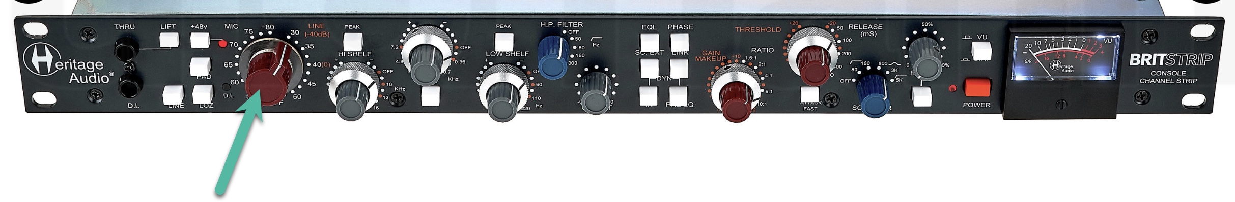

I have two Heritage Audio Britstrip preamps (with a +25.5 dBu output into 600 Ω) connected to my UFX III. The signal entering the RME (which has a +19 dBu input limit) is very hot; if I attenuate the levels analog-style from the channel strip itself, I feel I lose some of the "color" provided by the transformers. Should I use the technique described in this thread and insert a JTS (or similar) attenuator between the preamp and the UFX III input?
how about simply lower the output gain of the preamps ?

Thanks for the reply. The BritStrips have an output attenuator, but it is located on the EQ module; the compressor module—which lacks an output control—can be placed after the EQ. There is no single output level control for the entire channel strip.

ok, but it is still a mic preamp and has an amp gain, this is what I mean.
https://i.ibb.co/99VXWfq6/gain.jpg
In Neve-style preamps (which differ significantly from solid-state designs), the gain stage is coupled to a Carnhill transformer; beyond simply controlling the level, this component imparts added character and a vintage vibe. While it can certainly be used to lower the output signal level, that is not the intended operating philosophy for this type of preamp.
