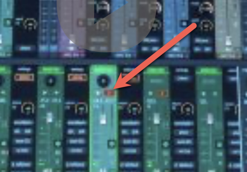

11 (edited by waedi 2026-09-29 12:59:59)
Re: Durec playback silent
In your second video about playback, I don't know.
May be the routing of these input channels to the loudspeakers, make sure the routing is correct to the main-out.
In the first video you try to playback on the output channel while the Rec button is ON.
I would try switch OFF Rec and try again.
I'm not sure if that helps, it is just what comes to my mind what I would try out.
