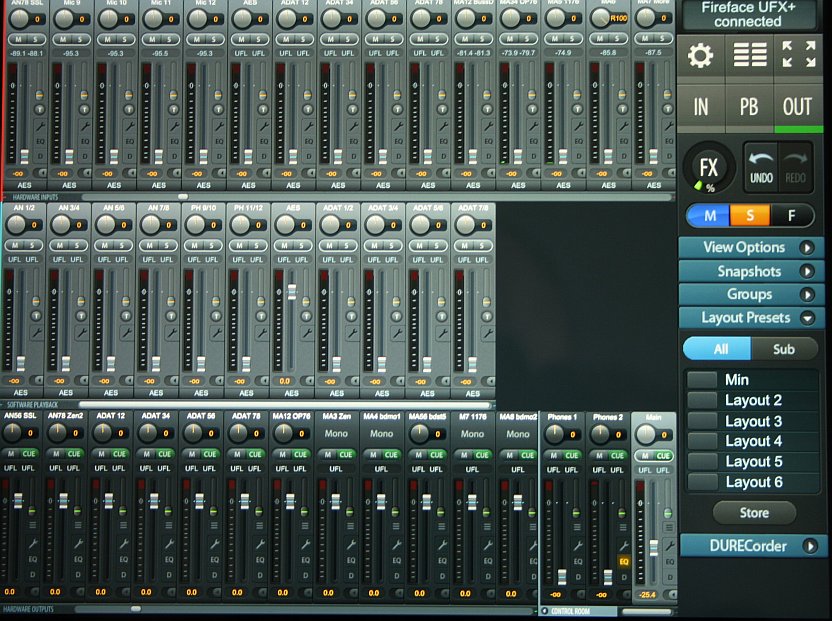

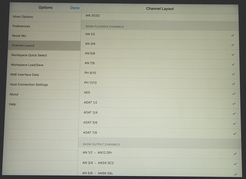

Re: TotalMix FX version 1.50 supports remote control over network (Final)
UFX+, TMFX Remote 1.1 on iPad with TMFX 1.5 Beta 5 on Win 10:
No MADI playback channels shown, not in Mixer view nor in preferences. Under Layout Presets "All" is checked.
http://www.ttx-sound.net/foren/IMG_7983.jpg
http://www.ttx-sound.net/foren/IMG_7986.jpg
fripholm wrote:
The input and output rows show all the channels, it's the playback row where MADI is missing on the ipad. Windows TMFX shows everything as well as TM Remote on another Windows machine...
Thanks for the clarification.

- If I close the Options by tapping "Done" while it is in the middle of the top bar and open the Options again, the "Done" button is still in the middle. Then hitting "Done" again and opening Options a second time, the "Done" button is on the right side of the top bar where it belongs.
This also happens when opening the Options, opening the selection menu on the left side, select an other category, closing the Options by hitting "Done", which then is the on the right side of the top bar and opening the Options again.
- Also, when I'm in the "Workspace Load/Save" part of the Options, the "Edit" button takes the place of the "Done" button on the right side of the top bar. To close the options frome here, you have to open the selection menu on the left side and hit the "Done" button which then apppears with the menu. Thats also kind of weird.
- Also had a Bug I can't reproduce anymore at the moment. When I closed the Options by hitting "Done" inside the selection menu on the left side and then opened the Options again, this selection menu was still open.
The "Options" button, which is normally located on the left side of the top bar and only visible when the selection menu is closed, slipped somewhere in the middle of the top bar while the selection menu was opened. In this situation i could step through the selection menu without it being closed like it would normally do when i select something in the menu.
- Also had one more bug which occured randomly. When opening the selection menu on the left inside the Options, the "Done" button, whitch then mormally slips into the selection menu, slipped to the right position but behind this selection menu. This mainly occured directly after starting the program.
I know, that this is a minor bug, but maybe it'll help you improving this awesome Software.
I also just testet the User management. It works fine so far. I know that this is a brand new feature, but a few things are weird (at least to me):
- In Totalmix remote for iPad: going to Options, host "Host Connection Settings"; why is the switch behind "User Authentication" labeled with "disable" and enabled at default? From my perspective the switch should better be labeled with "enable" and disabled at default. But maybe thats just my personal taste smile.
Edit: I just thought, why do you need this siwitch at all? You just tipe in your username and password, done. Maybe additionally an save button or something. Whether this has a function or not depends on if usermanagement is enabled in Totalmix 1.50 or not anyway. I don't know, its just a little bit weird. Maybe a little message inside the Options menu like "logged in succsessfully" or "Username and/or Password wrong" would be nice. And then a massage like "User management currently not enabled in Totalmix FX" or something like that if it is disabled.
Or on the mixer screen, in the top right corner where it says connected, you could add a row which says "logged in as ..." or something like that.
- Don't know how much of a programming effort this would be: In totalmix Remote for iPad; when i don't have Access to specific submixes or anything at all, i can still move the faders. Maybe it would be nice to gray out all faders I have no access to so i can't move them at all. (Maybe again, just my personal taste here)
Edit: another idea i just got: why not make the submixes i have no control over invisible so only the submix i have control over is visible? That would make the surface much cleaner. Maybe additionally with an option, where you can choose if you want the other submixes displayed greyed out or if they should be invisible.
- In Totalmix FX 1.50 on windows: going to options, network remote settings, add or edit a user, in the area "Rights"; maybe it would be nice to gray out the drop-down menu behind "Edit Submix" if this option is not selectet.
(personal taste again)
Besides (I don't know if this would be necessary yet) it maybe would be nice to have the possibility to choose more than one submix a user can have control over.

Thanks for the detailed feedback. To enable more than one submix it should be possible to use the same user name, with or without password, multiple times.
Edit: doesn't work. We'll check.

Will there also be an update to the ipad version that fixes the missing MADI playback channels on a UFX+?
Or is this supposed to be fixed already? Because on the ipad they still won't show at my end smile

Yes, update coming.
