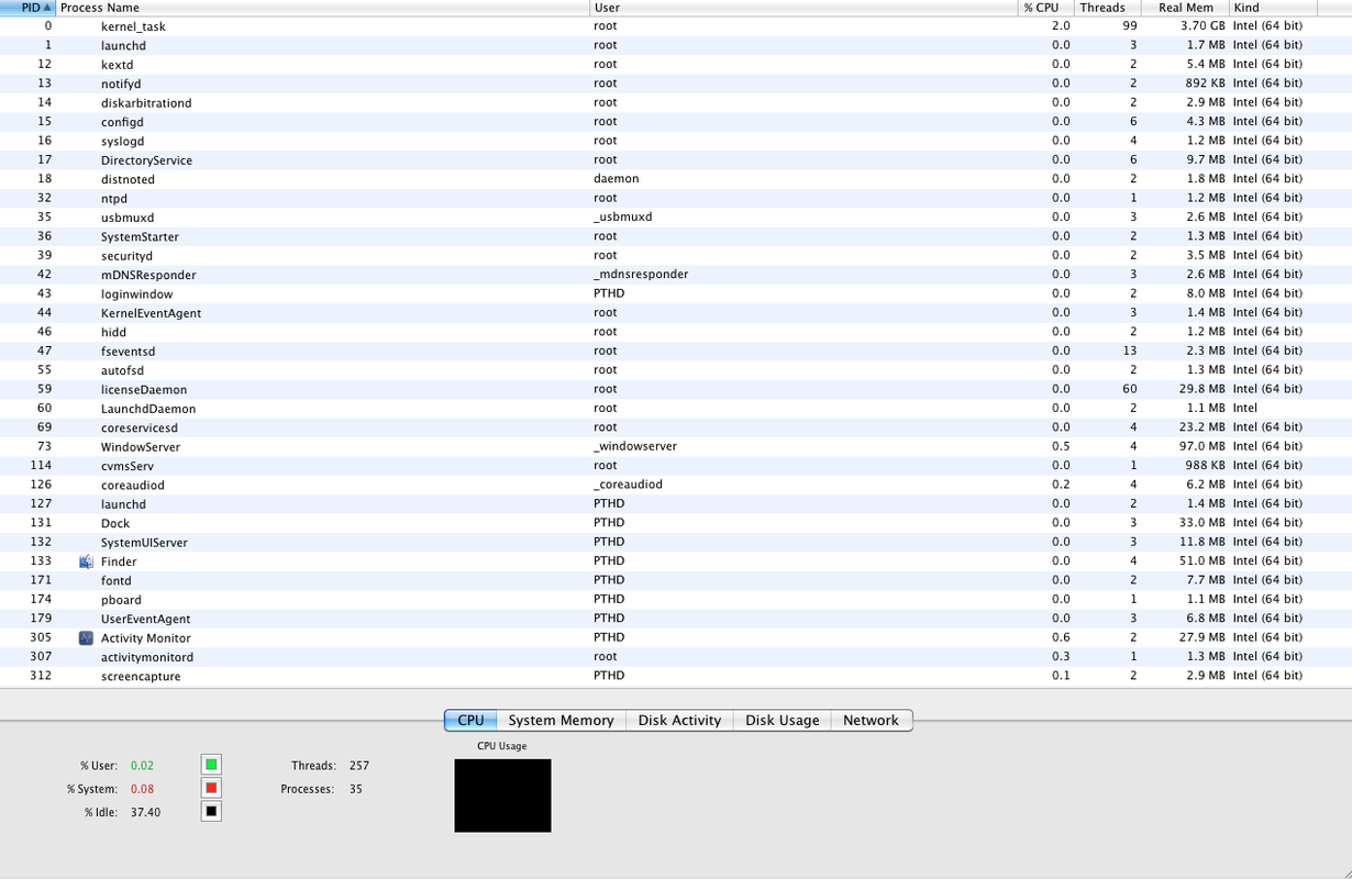

I have a 12-core Mac-Pro 5,1 for legacy Pro-Tools TDM sessions that still runs Snow Leopard.  The computer is an old beast running a truck load of Digi/Avid hardware/kexts/software, and here is a screen grab of Activity Monitor:
https://i.postimg.cc/66ZkfJ3H/Screen-shot-2019-03-16-at-9-32-36-AM.png
35 processes and 257 threads, 60 threads of which is the Ilok driver, no apps running, just the desktop.
My newer MacBook Pro with 16gb ram running a fresh install of High-Sierra is 218 Processes and 913 threads, ilok not installed, no apps running, just the desktop. My techs have been griping about this trend for years, now I know why.  From 2011/Snow Leopard to present this is a 600% increase in default running processes on OSX.
Effective Jan-1-2019, my corporate IT dept banned the use of employee Apple (IOS  and OSX) and Android devices on the company network due to security concerns and GDPR compliance (we have European locations). Our corporate version of Windows 10 has all of the spyware and telemetry stripped out.
I was shown a firewall log of outbound IP traffic from High-Sierra....could not believe the insane level of analytics and user telemetry data being sent back to Apple and other US technology companies with little ability to control it.  Orwellian US technology companies like Google, Facebook, Microsoft, and Apple are solely the reason the EU enacted GDPR laws.
