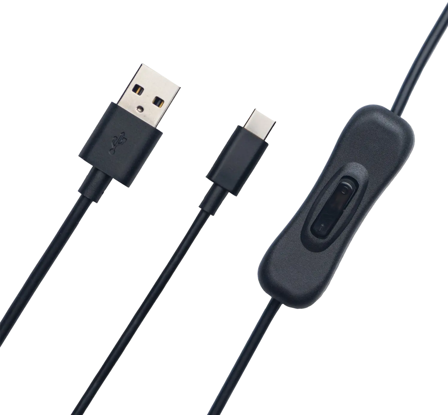

For the topic make USB off without pulling the cable :
There is USB cables with ON/OFF switch available for cheap :
https://www.digitec.ch/im/productimages/1/3/1/5/0/6/8/0/9/2/5/8/7/3/3/7/8/9/2/6ee5d327-b7e4-4b3b-84c6-7be34d12aad1_cropped.png?impolicy=product&resizeWidth=1440
